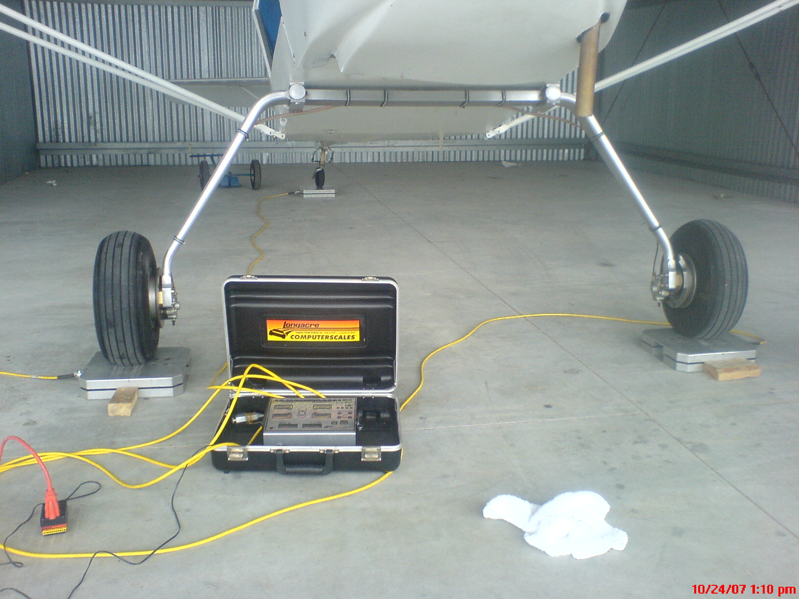

John,
First, let me say that my "5" has the typical "Experimental Amateur Built" airworthiness certificate, There is nothing special or different with 84KF. It was assembled IAW the factory construction manual, has a 921UL engine and 3 blade Warp Drive prop, spring gear, and, at present, an empty weight of 762 lbs.( See attached pictures)
The final empty weight of your aircraft is the key to flying it under sport pilot privileges..., along with a solid understanding of "The Final Rule", (the link posted below).
http://www.aopa.org/whatsnew/regulatory/sport_rule.pdf
Now, as stated in the Federal Register / Vol. 69, No. 143 / Tuesday, July 27, 2004 / Rules and Regulations, page 44791......
"The FAA believes that there might be confusion concerning what airworthiness certificates apply to lightsport aircraft. Therefore, the FAA is clarifying this issue. A sport pilot may operate any aircraft that meets the definition in ยง 1.1 of a light-sport aircraft, regardless of the airworthiness certificate issued for the aircraft. An aircraft that meets the light-sport aircraft definition may have any airworthiness certificate that may be issued for an aircraft, such as standard, special, primary, or experimental amateur-built aircraft."
Second, if we were to attempt to continue this discussion on line, here on the "List" we would be jumped on by the so called (cough cough) "moderators", all amatuer hobbiest, who don't have a clue what's going on, but will insist that a 25 year professional FAA representative and Part 147 educator is full of $#%&.
E-mail me at stevebenesh(at)comcast.net and we can arrange a personal conversation on the subject over the phone at your convenience if you care to.
Steve

Only one slight problem... You weighed your plane tail down. It should
have been weighed level. Put your tail load cell on top of a support to
lift the tail so the plane is level. For all practical purposes you may
notice a slight shift (probably forward) in CG.
Noel

avidfox
Joined: 03 Apr 2007 Posts: 87
Posted: Mon Apr 21, 2008 5:27 am Post subject: Series 5 Light Sport |
Noel,
The purpose of scales at that time was simply to determine (and verify) the empty weight.... which is the same regardless of attitude.
Steve

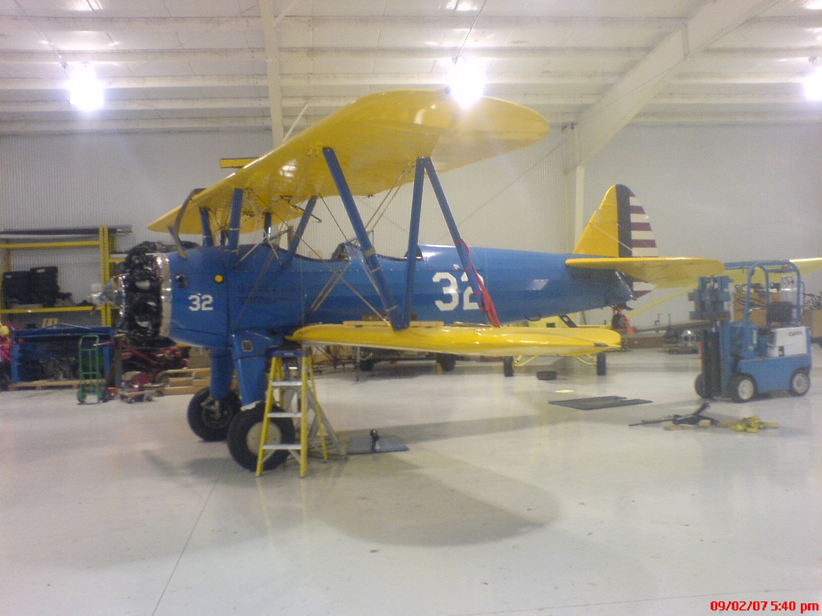

avidfox
Posted: Mon Apr 21, 2008 5:43 am Post subject: Re: Series 5 Light Sport |
..... and this is how I level most "taildraggers" for rigging and actual weight and balance work.
Steve

True but if, emphasis on the “if”, you use the info to calculate your W&B then the balance part will be off a bit. Practically speaking it may be very little.
Can I borrow your scales for a year or two... or ten J??
Noel

Float Flyr
Joined: 19 Jul 2006 Posts: 2704 Location: Campbellton, Newfoundland
Posted: Mon Apr 21, 2008 7:09 am Post subject: Series 5 Light Sport |
Wow!
Beautiful plane, Beautiful floor, Beautiful hangar!
Noel
