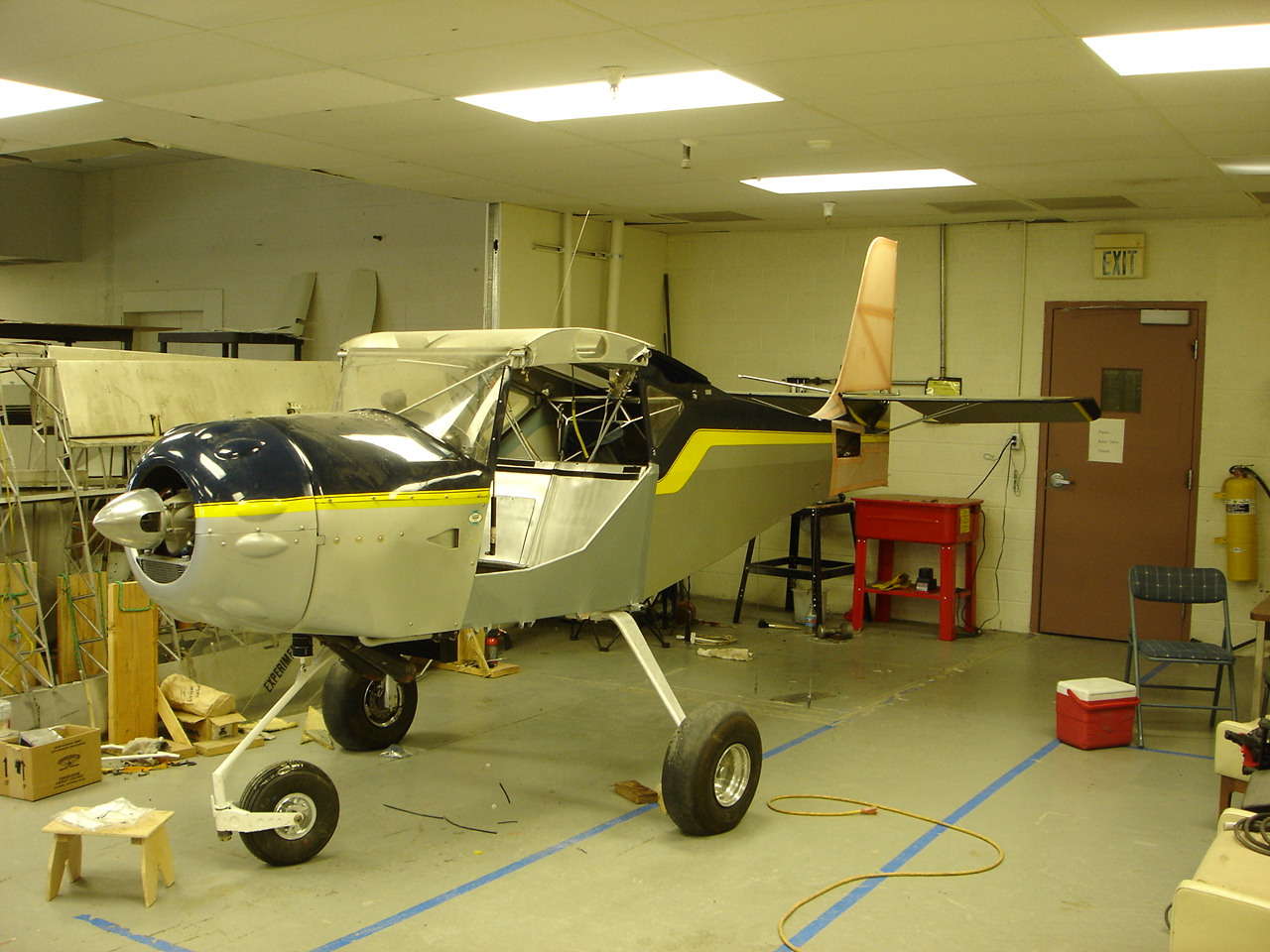

When I did my rebuild, I needed to add weight to the tail to offset the weight from the added nose wheel. I moved the battery to the tail section and welded in a plate with two upright bolts for holding ballast. I used lead weights for ballast with two holes drilled through them which line up with the two upright bolts. Wing nuts hold the lead ballast tightly in place. Note the open access under the horizontal stabilizer in the attached photo. We built a sheet metal plate to cover the access.
