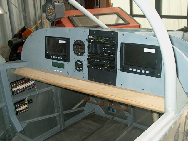

I mounted my fuse blocks directly to the fuselage side - dimpled the skin
and countersunk the holes in the blocks. They'll be covered by a sidewall
panel when the interior goes in.

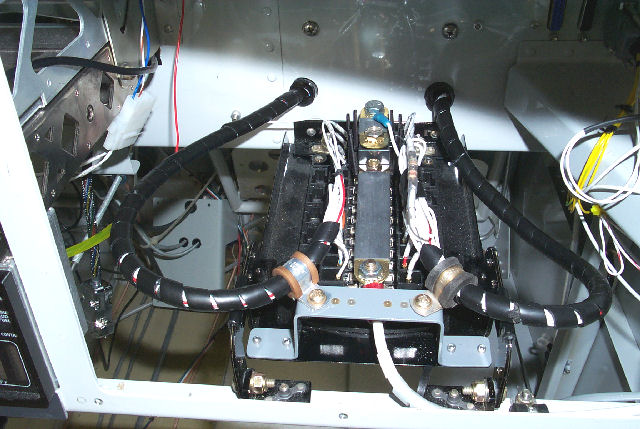

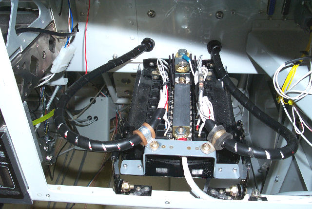

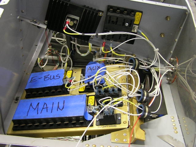

Here is yet another hinged option. This fuse block uses insert able
crimped contacts (no fastons and one less electrical interface). It is also
split 20 Main Buss, 8 Essential Buss. The two buses are tied by a schottky
diode bolted to brass busses (the stuff in the center of the rear of the
panel). The fuse panel swings down and forward from the front edge of the
panel and all of the wiring is in the rear.

I didn't mention that the Battery Buss fuse block is a 6 fuse surface mount
block like others you have seen. It is mounted on the Forward side of the
firewall inboard of the Brake fluid reservoir.
