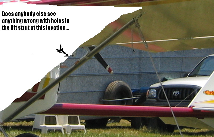

Hey Guys,
I've seen my"stock" Lift struts "wiggle/shake" in flight.....I'll be changing over to the streamline struts....
I'm sure they'll still flex alittle....
I've heard on the list that the chromemoly on the end of the lift struts have cracked on a couple of different planes....
Here's a picture of two holes in a lift strut....I'm looking for YOUR opinion if this looks like trouble waiting to strike....or are these streamline struts
"bullet proof" where these hole won't crack with repeated flexing....
Gotta Fly...
Mike in MN N381PM ( still improving it )

" Here's a picture of two holes in a lift strut....I'm looking for YOUR
opinion if this looks like trouble waiting to strike"
YIKES!!!!!! Maybe it doesn't have the moly inserts at the end but has a
full length moly tube inside the streamline strut?

You've got a GOOD POINT....I wrote John and asked him if a Chromemoly tube is running the Full Lenght....If that Streamline is just a
"Sleeve" then those holes wouldn't be a problem....
If not, Then what "you" said...YIKES !!!

Those holes would be real close to the top of my "Bad idea" list.

I'll check next time I go to the airport, but I believe it is a sleeve.

I don't know about Chromemoly Lift struts.....Mine are Stock Lift Struts.....Aluminum tube-inside an Aluminum tube....Then Chromemoly bolted on each end..... "MINE" wiggled and shook from time to time ,while I was flying.....I don't like that, so I'll be switching over to the Aluminum Streamline Lift Struts with the Chromemoly inserts like I already have...
And that is why I was questioning the holes in the lift strut in that picture.
"I" think the Streamline Struts are STRONGER....But, their still going to go thru SOME flexing ...
The problem with the Chromemoly on the Lift Struts that "I've" heard on THIS list.....Is, Some of them have been found with Cracks.....Didn't one guy "go down" because the lower chromemoly piece had weakened because of WATER , and then Failed in Flight....
I've Sheared tubing for lattus on Crane Booms ....Sometimes when the metal had a little more tensil strength the end of the tube would "split" when Sheared.....If this happened it would get repaired....but the rest of the Stock would still have the potential to do the same thing.....We don't know if Kolb is "seeing" any of this when they go thru the process....
When I've heard of cracks in the material, Thats where "I" think they were from....It just took alot of FLEXING to bring it out...
Gotta Fly...
Mike in MN
