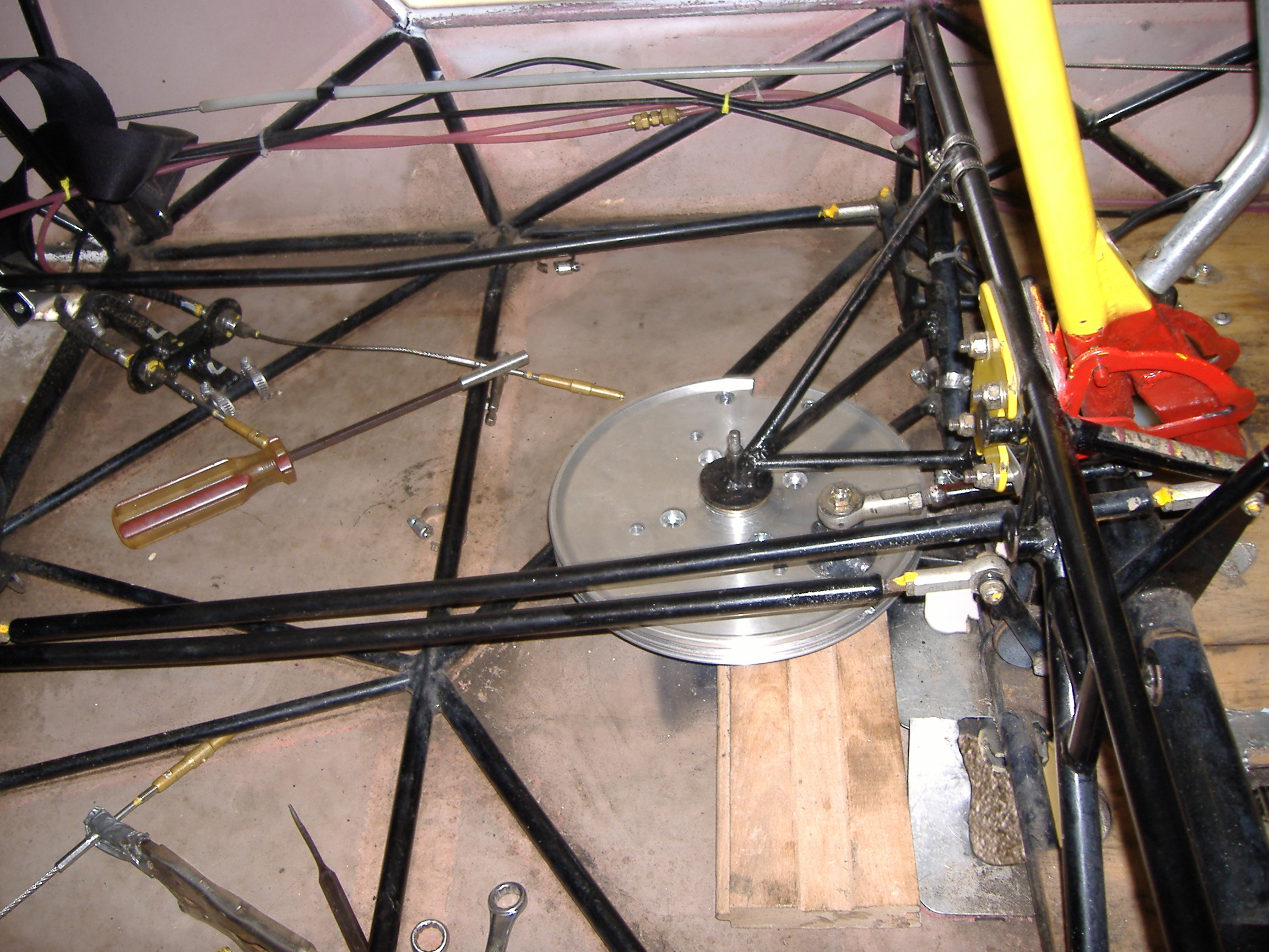

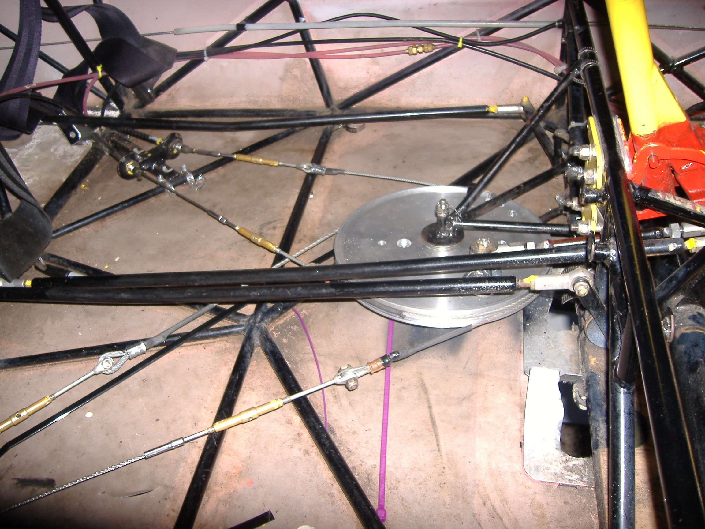

When i got my 1100s all i got was the floats, struts ,spreader bars and the johnson bar and cables from floats. I made the bullwheel and all 4130 fittings that goes under the seat. you need a good pull....... how much ? well i would guess 50 to 80 pounds at the most. It helps to have your should belt on.
I have most install info for the 1100s scanned online if you need it let me know.
