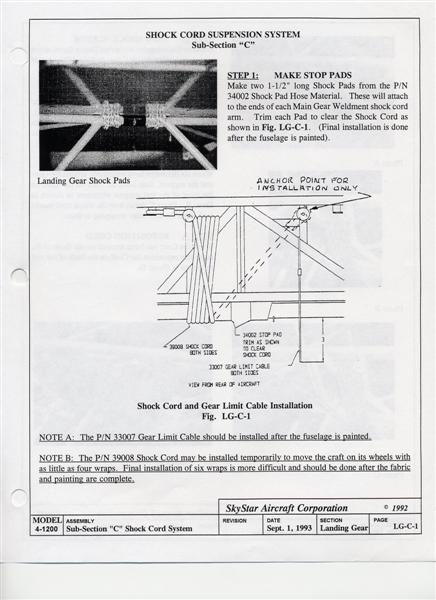

Hi Everyone,
Does anyone have the manual pages that are needed to install the bungee
cords on a model 3? We have a completed model 3, and the bungee cords
were installed by a previous owner. They need to be tightened, or
replaced, and it would be helpful to have this information and/or any
other advice.
Thanks in advance,
Jim Gilliatt
msm_9949(at)yahoo.com

PostPosted: Mon Jun 30, 2008 10:16 am    Post subject: Manual Pages Reply with quote
I posted these a couple months ago for model 2. Should be the same for the 3.
I'll try again via attachment. If they don't come through OK, please let me know.
Deke Morisse
Mikado Michigan
S5/Subaru/CAP 377+ TT
