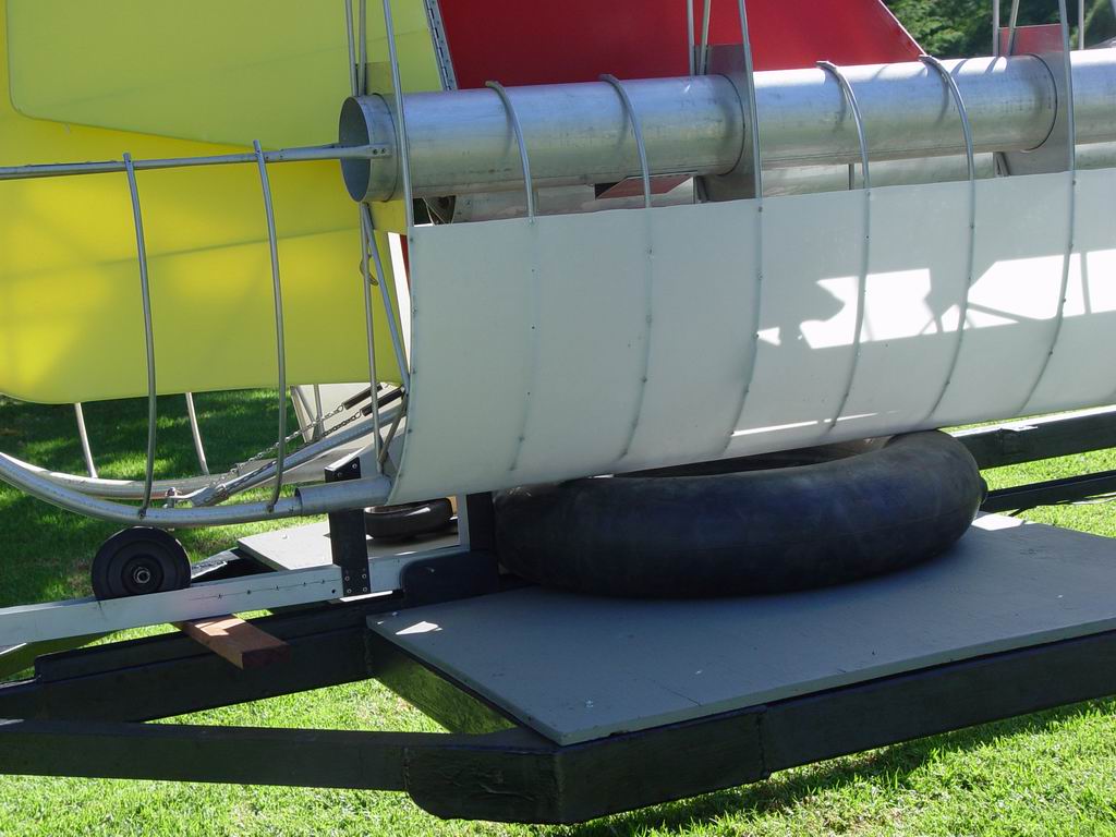

Another way to stiffen up the leading edge of the wing and to keep the ribs in column is to cover from the leading edge back to the high point of the airfoil with thin fiberglass sheet or aluminum. Rivet the thin sheet to each rib and false rib at about two inch intervals. It adds a couple of pounds to each wing, but really stiffens up the structure. It also eliminates the sag between ribs and makes for a cleaner airfoil. Do the fabric over the entire wing after the leading edge covering is intalled.
I built my FS2 wing this way, and I can guarantee that the ribs and leading edge are not going have any spanwise movement. I think this would be the most simple and structurally sound modification for a 5 rib wing. It does involve recovering the wing.

Not to beat this topic to death, but.....
Dave Bigelow
Kamuela, Hawaii
FS2, Rotax 503 DCDI
http://forums.matronics.com/viewtopic.php?p=20054#20054
http://forums.matronics.com//files/fs_with_fiberglass_le_covering_827.jpg
Its what we learn after we know everything that is the most important.
eagle1(at)commspeed.net

I used fiberglass rather than metal to avoid the dent problem. It takes some work to smooth the fiberglass sheeting over the ribs without wrinkles. The natural stiffness of the fiberglass prevents sagging between the ribs and false ribs. It is not attached to the main spar and does not act as a D-tube. It just stiffens up the leading edge structure and makes for a smooth sag free airfoil.
Dave Bigelow
Kamuela, Hawaii

"Another way to stiffen up the leading edge of the wing and to keep the ribs in column is to cover from the leading edge back to the high point of the airfoil with thin fiberglass sheet or aluminum. Rivet the thin sheet to each rib and false rib at about two inch intervals. It adds a couple of pounds to each wing, but really stiffens up the structure. It also eliminates the sag between ribs and makes for a cleaner airfoil. Do the fabric over the entire wing after the leading edge covering is intalled.
I built my FS2 wing this way, and I can guarantee that the ribs and leading edge are not going have any spanwise movement. I think this would be the most simple and structurally sound modification for a 5 rib wing"
Have you noticed any cracks forming in the ribs where the rivets are?
