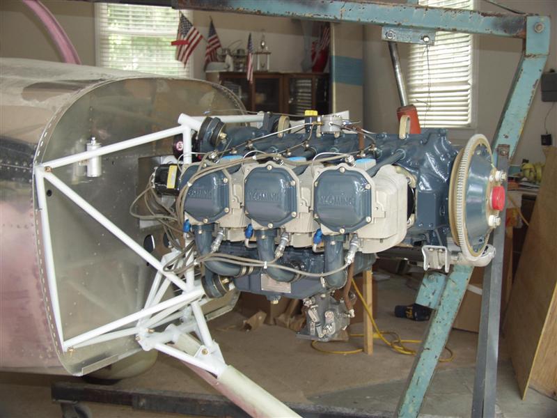

PostPosted: Sat Jun 28, 2008 5:27 am    Post subject: Re: IO540 need an engine? Reply with quote
Thanks for the input Kelly and Pete.
The engine arrived yesterday with lots of documentation and of course it looks brand new -- a little bead blasting and paint can make anything pretty, but it looks really professionally top notch.
There will be a ton of questions eventually, but for now we've mounted it (really only took a few minutes -- but understand the builder's warped sense of time!) so that today we can get the cowl fitted.
A couple of beginning questions: I've read about the newer, lighter starters ... this one has what appears to be a new starter, but how do I tell if it's old or new style? And, are shop manuals available for this engine? At first glance I noticed that there are 2 threaded ports on the back of each mag -- three are open, one has a cap on it -- what are these? It has one line connected to what looks like an intake port on one cylinder, the others are plugged ... ? I had to take the 90 elbows off the top of the vacuum pump to get it past the engine mount -- looks like I'll have to put an extension on the forward one to get it back on to clear the mount bar? What's the vacuum pump for? Sheesh, so much to learn, but it's Xmas in July!
I think my partner will probably hire a Lycoming guy to do final installation, but I'd like to learn everything about this engine. A shop manual would probably answer these questions (and hundreds more) but I thought I'd ask here for a quick response, and maybe point me in the direction of "how to" books for this engine like others have recommended for basic building and flying.
The first car engine I pulled and totally rebuilt was a Jaguar V-12, so this looks like fun to me!
Later, - Lew
