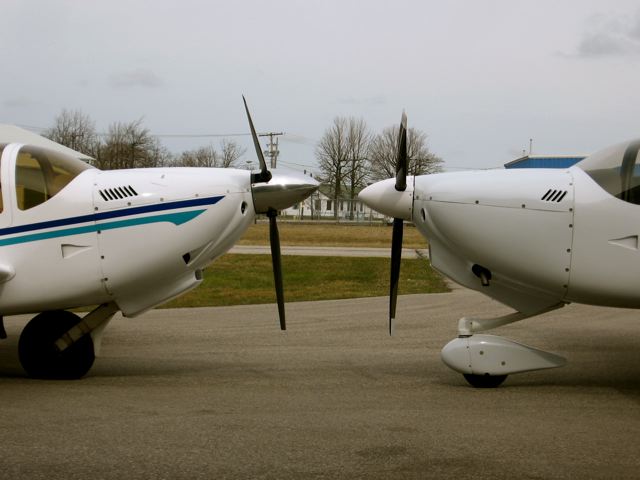

Chris Staines made a fairly easy amendment to his lower cowling, by
cutting a slit at the bottom and folding it up.
Then cutting out a wedge and re-glassing, also moved the inlet back
to just in front of the rad.
He indicated it may have added a knot or two to the cruise, did not
affect cooling.
Photo attached ( I hope).
