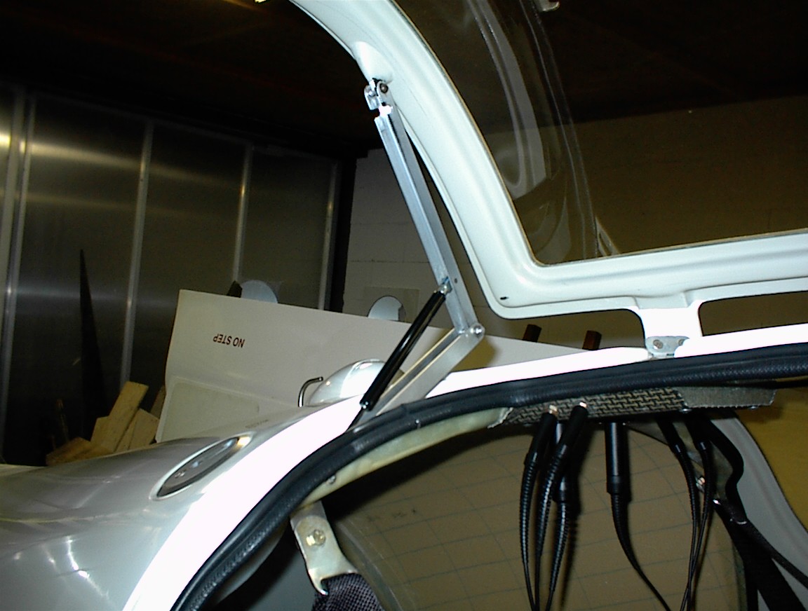

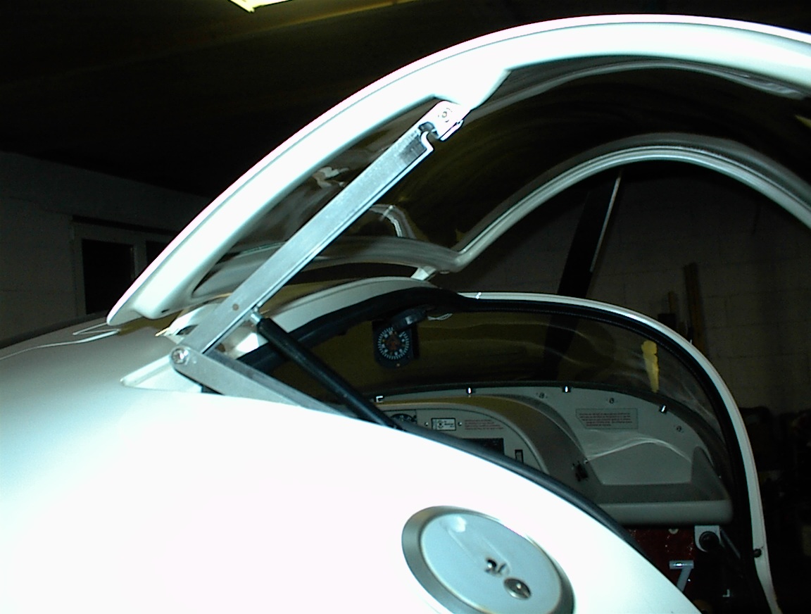

Bob,
In attachment two pics of a modified Ted Gladstone concept. I reinforced the
fuselage to accept the harness belts.
Best regards,
Karel Vranken.
