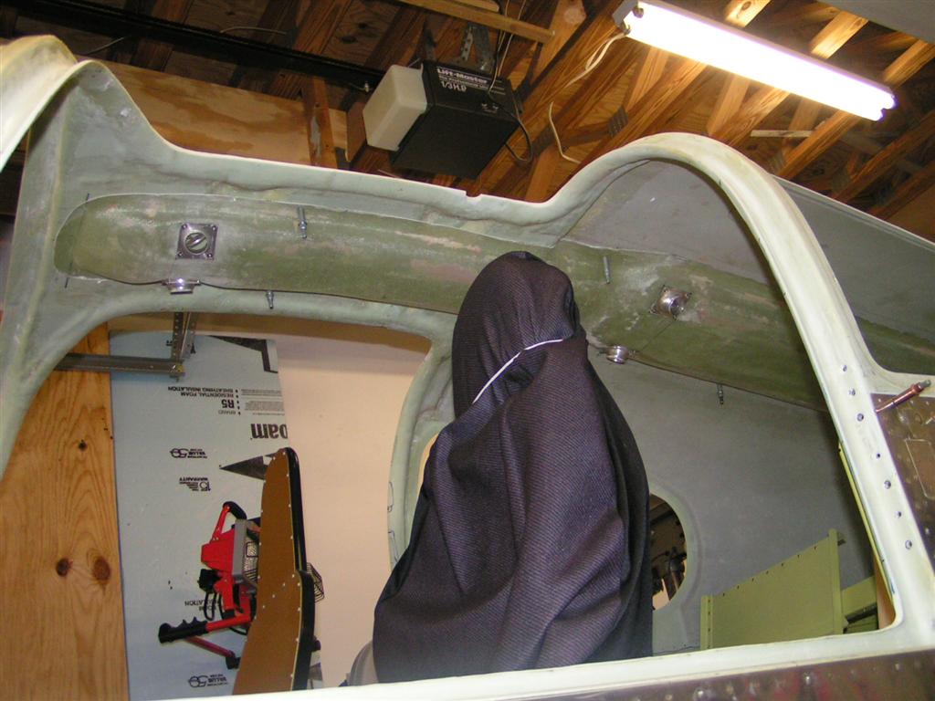

Thought I would share some photos of my recently completed overhead console. I think it came out pretty good. I am still finishing it up and need to add nut plates to mount the vents, also need to add access plates etc. I used blue foam as a mold. I shaped the foam and then taped it on the top. I used tape around the edges to protect the cabin top. The fillet was done with spackling compound. I sanded the foam and spackling smooth and then covered with mold release wax. Yes it took some time but it was not difficult to do.
So... it can be done without buying after market if desired - no special skills.
-Chris Lucas

Congratulations Chris! while it's not the tidiest environment to work
in, fiberglass can be used for any number of applications, your project
was an ambitious one, but it looks like it turned out quite well,
Deems Davis

Well done! It looks great and is much less obtrusive then all the other options I've seen. I've done a lot of fiberglass work (built a Q2 as my first project) but am not sure I could pull off what you did so well.

You mentioned nut plates, and I wanted to tell you about these: http://www.aerocraftparts.com/Categories.aspx?Category=07adfbee-0ad0-4593-a52e-30065aedb553
Just drill your hole in the f/g part and epoxy these in. You pull them into the drilled hole with the colored rubber bungy and when set-up you just pull the bungy out and your done.

I always wanted a Lancair but settled for the RV-10 ;>) I shyed away as I learned more about composites, I would worry to no end about my quality of cure I would be getting here in humid eastern CarolinaI, but I actually kinda enjoy fiberglass in that it offers so much potential though there is a price (time and mess). .
I built the courage up to do the console from following the master of mod, Deems Davis! Thanks Deems.
These nut plates are interesting, a bit pricey I'd say. Thanks for the heads up!
-Chris

Thanks Marcus, it really is not that hard, I did vascilate on the size especially the thickness. Also I will have a headliner to cover the imperfections, and there are a few.
