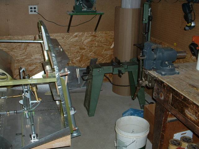

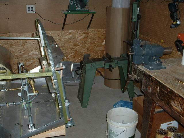

Andrew, looking at the size and picture of your workshop, I would consider the HDS a better choice than the XL. The wing panels are significantly smaller and more easy to handle. This was the main reason for me to prefer the HDS.
OTOH the HDS unfortunately is not supported and updated as the XL is. No QBK, no CAD machining of kit parts and so on.

1. Larry Mac built his own, but it's easy to infer from the pictures on
his site and reading his log that it's neither cost effective to do it
yourself nor a job for the faint of heart.

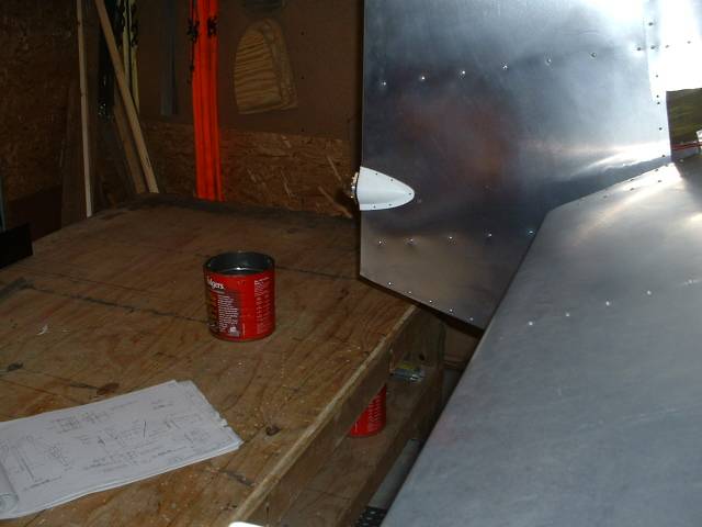

2. The most significant thing ANY builder can do is take a couple of
days off and build a cradle on casters for the fuse. My shop is 14'x28'.
Take a look at my fairly recent attached pictures- think I could live
without the cradle? Yes, I have workbenches at both ends- another big plus.
If you're scratchbuilding, you're better off with the HDS because you can
get by with a shorter brake.
3. HDS parts are supported, but the plans and manual haven't been
updated in years. In my opinion, matched hole CAD doesn't mean squat, but
preformed upper longerons and injection molded lower nose gear mounts and
the like will save you untold hours of work and lost sleep.
