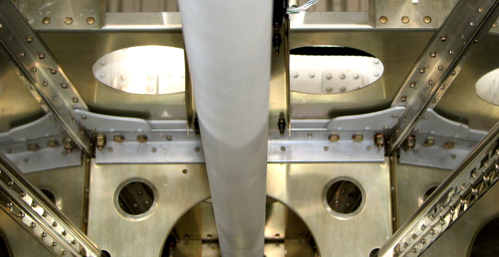

Over a year ago, while working on the emppange, I installed a gusset on each side of the same area in question in the SB. Can someone take a look at what I did and comment as to whether this should take care of the problem? Thanks guys.
Don McDonald
#40636 - finishing the finishing
--- On Thu, 7/24/08, Kelly McMullen <apilot2(at)gmail.com> wrote:
[quote]From: Kelly McMullen <apilot2(at)gmail.com>
Subject: Re: Sb 08-6-1
Date: Thursday, July 24, 2008, 3:04 PM
[quote]--> RV10-List message posted by: "Kelly McMullen" <apilot2(at)gmail.com> I've heard speculation from someone close to the situation that they believe that the bulkhead simply wasn't properly deburred on that one aircraft. Given that it was primarily used for transition training, with a lot of stalls shaking the tail, it wasn't too surprising. More significant is that no one else seems to have found a crack, nor was there one on 410RV. On Thu, Jul 24, 2008 at 1:44 PM, Chris <toaster73(at)embarqmail.com> wrote: > John, you make some excellent points. >
 Filesize:  130.2 KB
 Viewed:  568 Time(s)
Don A. McDonald
