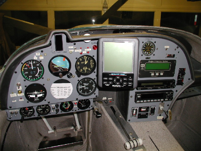

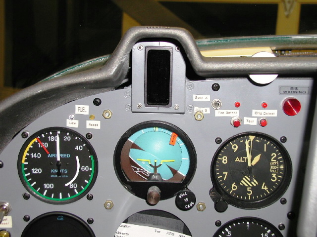

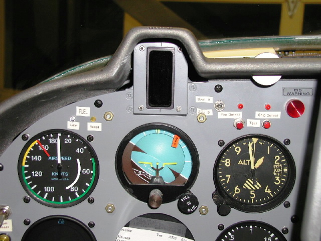

PostPosted: Mon Aug 04, 2008 8:14 pm    Post subject: Safety matters including stall and AOA warning units Reply with quote
Here's a pic of what Jim Nelson did for an AOA on 058.It's an Advanced Flight Systems AOA Pro.
Very slick - still learning how to calibrate it.
