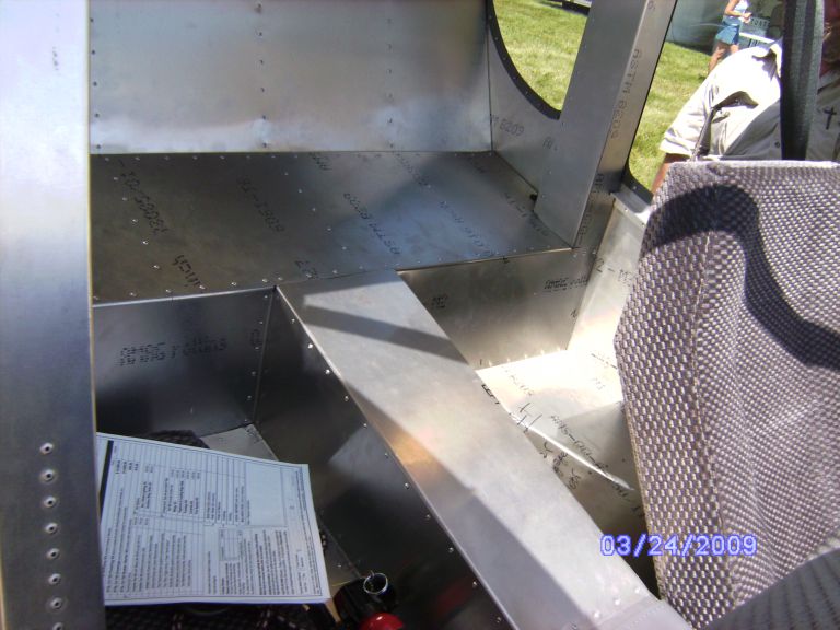

The tires are the same too, but I don't have those yet... so I guess I'll keep building my 701.. I do like the cabin better but you can put some windows in the 701 baggage bay. I like the windscreen wrapped around the side, but I do not like the smaller instrument panel it requires. Hands down the seats are better. If I were going to buy a 701 or a 750 kit, the new mfg process alone would make it a hands down 75o choice! I guess I'd have to put the turbo on the SVS1300 then!
Kevin
additional:
The baggage area is not even, as there are two recesses, due to controls. But I can envision some doors to restrain the baggage as well as a hinged window to access it from out side.
