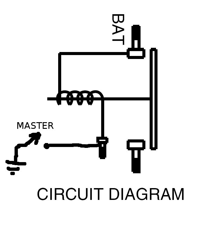

I noticed the battery contactor only works with the large post opposite the
small post connected to positive and does not work with the other large post
connected to positive (i.e.. flip flopping the positive)
This does not seem to be the case for the starter contactor, it seems to
work with either post connected to positive.
Is there a reason for this?
bob(at)bob-white.com
PostPosted: Thu Aug 07, 2008 5:35 pm    Post subject: relay wiring question Reply with quote
Hi Jerry,
The reason is on the starter relay, the coil is activated by a positive
voltage to the small terminal and the case is grounded. It has nothing
to do with the large terminals. On the contactor, one side of the
coil is connected to one of the large terminals (BAT). The other side
is connected to ground through the master switch. If you connect the
large terminals backwards, then one side of the coil is NOT connected
to the battery and you can't activate the coil.
You have to get 12V across the coil to activate the contacts on both
devices. Look at the attached drawing and it should be easy to see why
you can't switch the large terminals on the contactor.
Bob W.

nuckolls.bob(at)cox.net
PostPosted: Fri Aug 08, 2008 10:42 am    Post subject: relay wiring question Reply with quote
I discovered a diagram I'd published a few years ago at:
http://aeroelectric.com/Pictures/Schematics/Contactors_PU_and_PD.pdf
In this drawing, you see the control paths for the
classic "pull down" to ground control of battery contactor
(shown in red) and the "pull up" to bus control typical
of starter contactors (shown in green). I've also published
a one-pager on the three common contactor wiring conventions
at:
http://aeroelectric.com/Pictures/Schematics/Contactor_Wiring_Conventions.pdf
