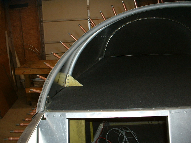

All-
OK, here's how I did it. This is assuming you already have the hoop holes and the formers drilled:
1. Cleco everything you've got holes for. Leave the last foot or so foreward of the mid top undrilled.
2. Install the cockpit side.
3.Work the "Bubble" out of the mid top aft to front. Drill and Cleco the center of existing holes afterwards. Pitch 20 or 30 by the time you're done doubling. Zero gap at the hoop a necessity.
Bill Naumuk
Townville, Pa.
HDS 601MG/Corvair 95%

Excellent Bill!
You finally beat it into submission. Congratulations.
Looks really good!

Jeff-
.020. I figured it would be too hard to make a nice looking bend at the front of the hoop with .025.
This is actually my third mid top. My original kit material was too corroded to leave on, but I used it to make a pattern, then transferred it to another piece of .016. Didn't like the way the .016 dimpled when riveted around the hoops and formers so I tore everything down and went with the .020.
Bill

Larry-
Third time's charm! This weekend is it. If I can finish the mid top
successfully, the sheet metal work is essentially done. And to think I did
it in only 5-1/2 years!
Bill
