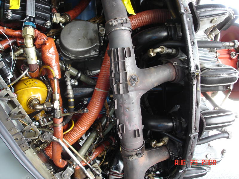

I finally got around to taking a picture to show what all -52 drivers need to be aware of.
The inner pipe of the exhaust section which contains the baffling and shroud for the cockpit heat split open. You cannot see this split because it is hidden inside the heat shroud. If you remove this section and inspect the inside of the inner pipe you may see any splits.
When this pipe fails you are getting CO pumped directly into the cockpit via the cockpit air vent system. And you have no way of knowing this is happening. I have no idea how long this pipe had been split and I was getting so much CO. The split in my pipe grew until I finally realized something was amiss when the air from the vent between my knees was so hot it was burning my legs. Raw HOT exhaust was being pumped straight into the cockpit.
In the pictures you can see what this section looks like with the heat shroud cut off. You can see the small sections of U-channel that hold the shroud away from the inner pipe. They are spot welded on and many of the spot welds have failed, leaving more holes in the pipe. You can even see a new hole I found when I took the picture. You cannot see the BIG patch on the back side of the pipe.
I STRONGLY recommend that you remove this section of exhaust and inspect the inner pipe for any leaks.
You can see in the picture the new air supply hose I rigged up...works great, but no heat now.
Does anyone have just this section of the exhaust available?

This is what you cannot see until you cut the heat shroud off.

Thanks Steve for this important information, YAK owners, standard and TW's
take note of this information. I have a digital meter that I plug in
occasionally to check for gas. I have not to date found a high level except
while doing run-up. Then only with the canopy partially closed. However
lately on start-up at times I will get oil smoke through the heat duct. As
the TW owners know at times due to oil passing the exhaust valve on the
number one cylinder , oil will run down the exhaust on the right side. This
causes oil to blow out of the exhaust on start-up. After seeing these Pics,
I now believe I have a failure under the shroud such as seen in the Pics.
Due to oil actually entering the heat duct. Guys with winter coming on we
will be operating more with the canopy closed. Check for gas with an
instrument and check the system. You can bet I will be checking ASAP.
to be aware of.
the cockpit.
Fly Safe,
Steve Dalton

That is good information and indicates the need for sharing information such as this. I have some 2,500 Hrs in both the standard and TW YAKs, and have yet to pull one for inspection. Indicates that this a learning business.
After some fourteen years of flying these things, I should have known better, and you can bet I am not pissed off to hear about it. Everyone should take this information and go with it. Also it would be interesting to have feed back from all owners that find problems.
Lefty

In Canada it is an Airworthiness Directive that applies to all aircraft regardless of certification status.

How do you remove this shroud for inspection? It is all welded together and has to be cut off for inspection.

Have you thought about scavenging air off the back of your oil cooler. It
can be done with the 50. The 50 does not have a heat shroud at all yet with
the air that bleeds into the cockpit from the oil cooler with the door
closed or cracked the 50 stays warm even in 20 degree weather. My oil cooler
is farther forward on the nose than yours in the 52 TW. I'm less likely to
get exhaust gas vented into the cockpit from there. It gets in around the
opening at the tail wheel. Yes I have measured the CO concentration at the
tail. It averages 50 to 60 ppm in the aft empennage during taxi and TO.

A question I should have asked, another reason to have the detector
available for spot checks, or perhaps a Perm. installation. One has no way
of detecting just when the failure occures. An internal visual can be done
by use of a light and mirror I suppose. This should expose anything but a
crack. This of course would open as the exhaust expands from heat.

Is it possible to scavenge warm air from the top of the inspection plate on
your oil cooler. The 50 does not have a heat shroud on its 2nd section of
the exhaust on the right bank. It gets so warm inside the pit of the 50
since there is an opening at the top of my oil cooler that I had to install
an insulation blanket on the top of the cooler. It did not seem to make much
difference in the amount of CO getting into the nose by doing that though.
My cooler is mounted farther forward than the ones on the TW. My exhaust
vents parallel to the cooler not in front of the cooler like the TW's. Tim
Williams installed fins on his cooler to vent the hot exhaust away from the
cooler as I remember.
I suppose exhaust stack extensions could solve the problem too.
Anyway, if you could capture the heat off the cooler then you would not have
to reinstall the shroud.

I only need heat in the dead of winter while cruising at altitude and the standard -52 system works just fine for that. I don't want to engineer a whole new system to replace one that works fine.
However, like many other systems in our planes it must be inspected to insure it is working properly...lest it bite you. And inspecting this section of exhaust can only be done by removing it and looking closely for any cracks inside the inner most pipe.
I suspect my -52 isn't the only one that has not had such an inspection done in a while...if ever. I also suspect there are other -52's out there right now with cracked pipes that are pumping CO into the cockpit. What are the odds that only one -52 in the world (mine) had an exhaust crack in that section of pipe?

Mozam
Joined: 24 Nov 2006
Posts: 85
PostPosted: Sun Aug 24, 2008 10:58 am    Post subject: Re: Yak-52 Exhaust Danger Reply with quote
Doc,
My exhaust is original, installed at factory in 2001. It has about 600 hours on it.
Keep in mind, you cannot see the cracks/holes in this section of exhaust while installed on the plane. On the outside it looked like new...but the inside was totally rotted out! Be careful out there.
-Steve

Mozam,
Copy. Will bore scope the stack.
Doc
