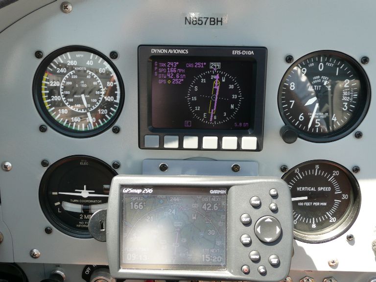

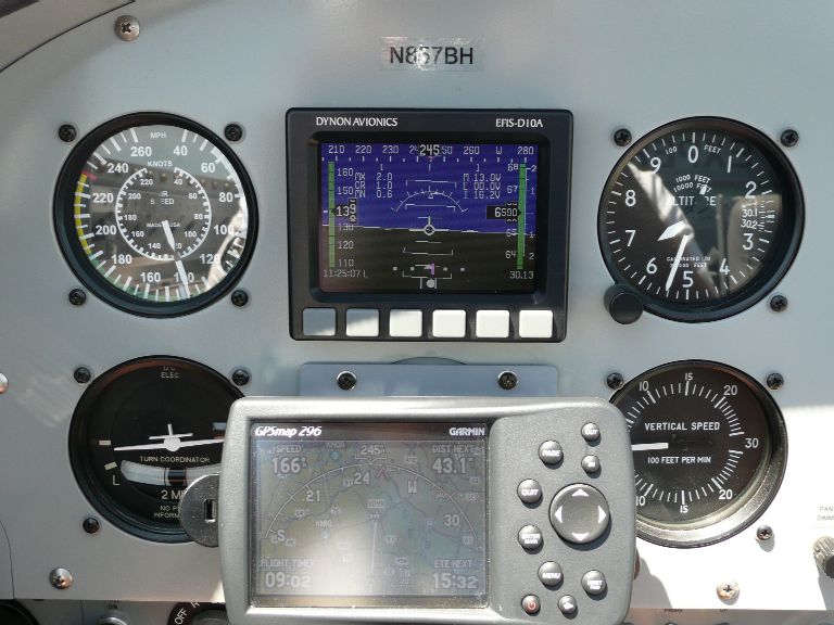

I have it and yes it works great! Not real hard to connect, you'll have
to tee into the pitot and static lines, and run a few wires (not 25).
You can see how I have mine in my panel in the attached pictures. The G
meter is just an option that is available and does not require any thing
extra to install. The second picture I attached is the optional screen
you can bring up if you have a Garmin GPS wired into it.
