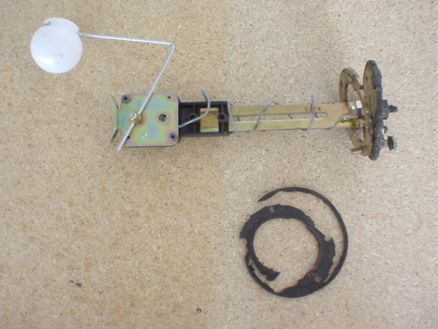

I had a problem with the VDO Neoprene Fuel Sender Seals on my 601XL.
I originally sealed them with a thin coat of Sealube and I had no problems
for the first
1/1/2 years using 100LL exclusively. Then I placed 92 octane auto fuel that
contained ethanol of 10% into my
tanks. The station assured me there was no ethanol in their fuel. I should
have tested it prior to pouring it into the tanks. I tested it after it was
in the tanks. I thought that I could burn this one
tank off as long as I remained below 3000 Alt I should not have any real
problems.
It was in my tanks for 2 weeks before my fuel filler caps were becoming very
difficult
to remove, the fuel drain valves began to leak, and the VDO Fuel Senders
began to leak.
I drained the tanks and tried to reseal the tank senders without any luck so
I pulled them from
the normal access holes which turned out to be much easier than I expected.
I have attached a picture of the total destruction of the gasket material.
These are the original seals
that come with the VDO Fuel Senders.
I found new VDO seals available from http://www.Eguages.com for about $5
each.
Whether it was the ethanol or some other additive maybe this report will
save time, money, or increase safety.
Additional pictures are on line (at)
http://picasaweb.google.com/Papawobo/trouble
Gary Ray
davgray(at)sbcglobal.net

Do you have the part# for the seals? I tried finding the seals but not sure which ones would fit.

Part No: 226-053 Notes: Neoprene, 2 1/8" bolt circle (54mm). By VDO.
Actual page address of sender and gasket
http://www.egauges.com/vdo_send.asp?Sender=10_180ohms
Gary Ray, 601XL, WW Corvair 2700 cc
