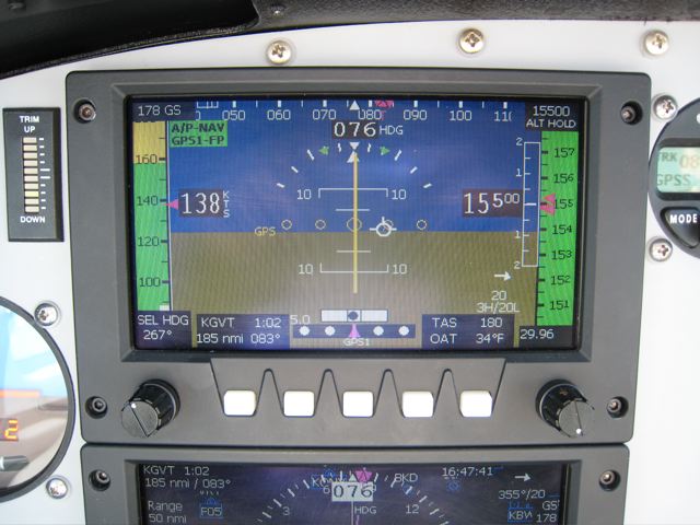

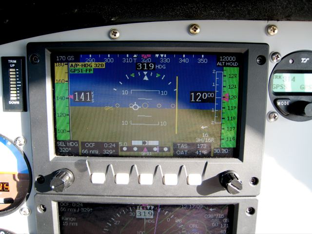

I was thinking about this....may be I mean to say that at a given
manifold pressure (19.0 in my case), 2250 RPM, 10 gal and 12,500 (65%
as stated in lycoming HP chart) I will lose speed if I increase RPM
and keep everything else, including fuel, constant.
Now guys, don't jump all over me for being wishy-washy!
Rene, you should always be able to go faster at a higher altitude!
Right?
At the end, I believe that we are very close to each other since it is
hard to make a major rigging error on the 10. We are just measuring
with different instruments and comparing speeds at different parameters.
I have enclose two photos of my panel from a trip. They are both
taken on the same trip at different altitudes. I have done the GRT
speed correction but will try the GPS speed calibration for the next
one. Now, if my outside temp sensor is really out of wack and my
numbers are off, it is not my fault!
I took these shots with the AP engaged and the plane level in smooth
air, with everything settled. Notice no vertical speed, TAS on the
right bottom and OAT.
You might think that I am a real liar, but if I wiggle my rudder just
right, I get a couple of more knots.
