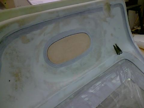

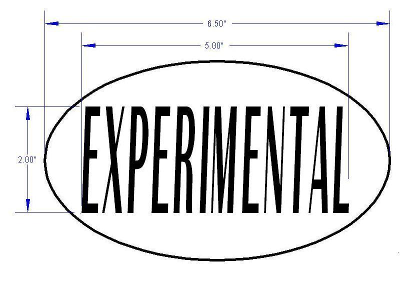

Since I was doing a custom interior, I didn't really want to use the standard "Experimental" sticker or the size of the letters. I checked with EAA about the FAR and what is really required. They told me the wording has to be at all passenger entrances into the aircraft. The great thing I found out was that the only size requirement for the EXERIMENTAL is it has to be at least 2" tall and not taller than 6". This was perfect. I used my computer and condensed the wording down to a 6" length but still had the 2" height. A wood placard was made with the lettering engraved in it and will be inset into the upper interior door panel. I attached some pictures on what I did.
