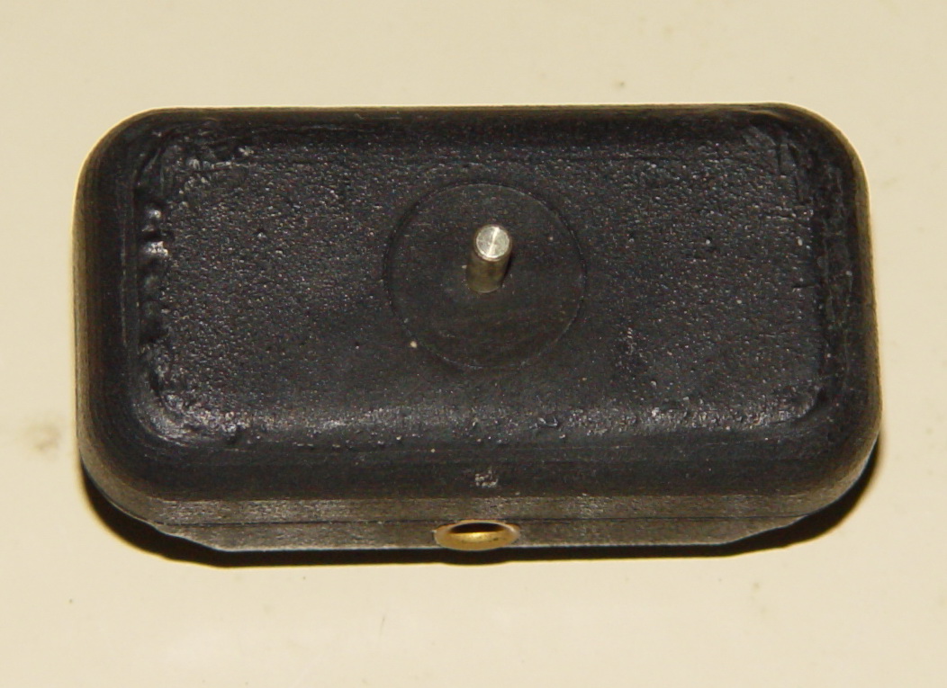

Float Covering, " Paint " like material bubbling and comming off the float :(

Attached is a picture of the bad float, its a bit hard to see, but
look around the edges of the float where the paint is starting to
bubble up.

grantr
Joined: 12 Sep 2007
Posts: 217
PostPosted: Fri Oct 03, 2008 11:14 am    Post subject: Re: Check your carb floats!! Reply with quote
Mike,
Thats what mine looked like. One was in much worse shape with large bubbles. They do seem to like to bubble around the edges.

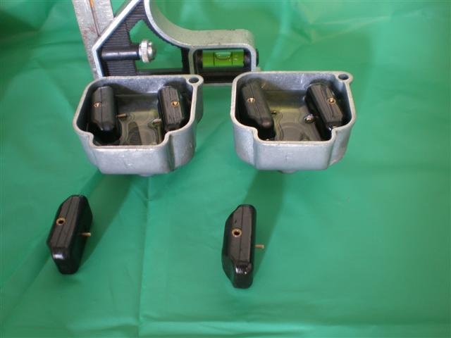

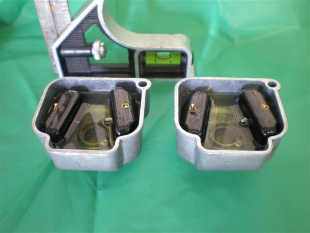

grantr wrote:
----SNIP----
I pulled my float bowls the other day and examined the floats and found one that was literally flaking apart!
After Grant's findings, pulled my carb bowls to examine the floats more closely than I do when I pull the bowls checking for stuff that ought not to be in the bowl.
Floats were not flaking and seem to be pretty solid.
However, thought I noticed one was lower in the fuel than the other. Set the bowl on a level surface and it was almost a 1/4 inch lower in the fuel. Pulled the other bowl and found exactly the same thing. The rear most float in both bowls was not sitting as high in the fuel as the forward ones.
Replaced the two that were down with new ones and all are about the same now.
Pictures are attached.
Dual carb, R503, Firestar II
Anyone want to speculate as to the reason just the left ones seem to be affected????
With new floats on left side.

PostPosted: Fri Oct 10, 2008 8:37 pm    Post subject: Check your carb floats!! Reply with quote
Hi George,
When the Kolb is parked, the rear of the engine is slightly lower than the front and the carbs are tilted toward the rear. Thus the rear floats are sitting in more fuel than the front ones, albeit a very small difference. While the Kolb is sitting in storage, the fuel in the float bowls evaporates and the rear floats are exposed to the fuel longer than the front ones. They get saturated with fuel and then don't float as high as the front ones which are more dried out. I have no idea if this is the case, but it sounds good, don't you think?
Bill Varnes
Original Kolb FireStar
Audubon NJ
In a message dated 10/10/2008 10:22:33 P.M. Eastern Daylight Time, gtalexander(at)att.net writes:

PostPosted: Sat Oct 11, 2008 7:27 am    Post subject: Re: Check your carb floats!! Reply with quote
Bill Varnes
Audubon NJ
Bill:
You win the prize... now I have to figure out what it is....
Your theory as to the reason is one that I had thought and also one offered up by "The Man" at THE Rotax Service Center in Central FL.
