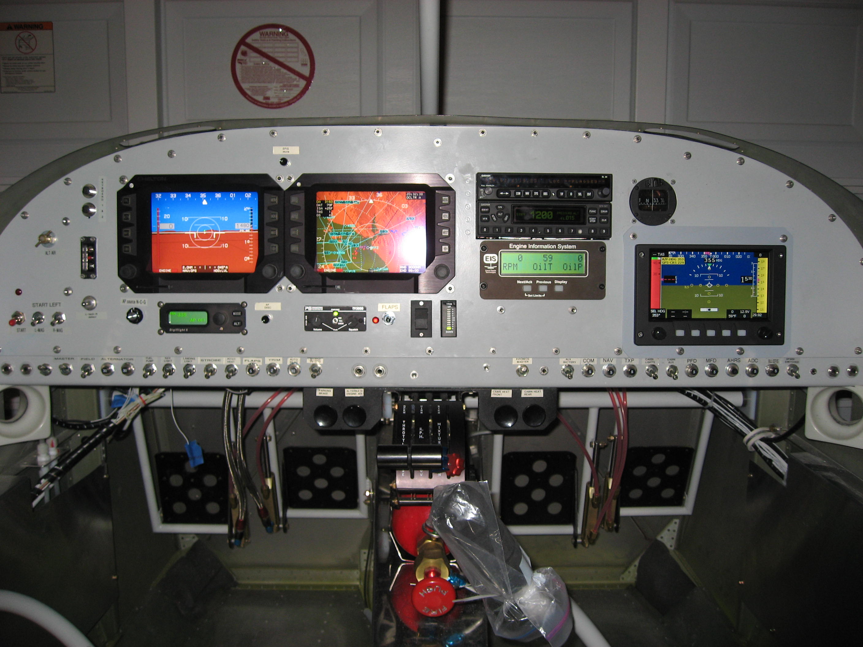

The firewall forward runs are in FF1-3. the inside runs are user choice. Mine are two knobs on the right side of the throttle quadrant. see picture

Note - do not do a permanent install till your panel is all ready to install as the heater cables have to be removed and run thru the hole in the bracket or panel.
