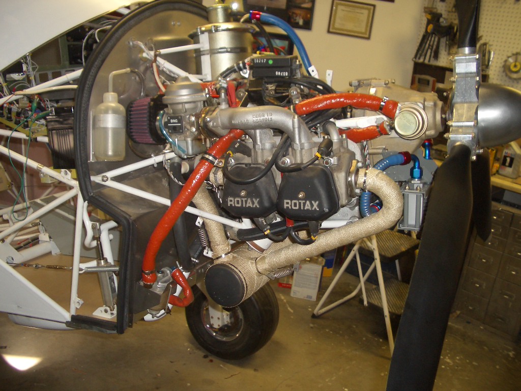

I recently decided to remove the carb heat system that was installed on my Model IV in favor of a simplified installation with the filters mounted right on the carbs. The problem I have is that the coolant overflow bottle is in the way of one of the filters. The firewall is rather busy and I don't see very many options for mounting. Anyone have pictures of a similar setup?

Lewis,
I did the same thing on my IV. I removed the conventional carb heat box and scat tubing, replacing it with electric carb heaters, and installed two K&N RU-1820 filters. Attached is a picture of the right side.
Keith Schneider

I did the same thing on my IV. I removed the conventional carb heat box and scat tubing, replacing it with electric carb heaters, and installed two K&N RU-1820 filters. Attached is a picture of the right side. [quote]
Thanks Kieth. Your installation looks similar to mine in the amount of room you have. Unfortunately, the air filters I picked up are larger than yours. Here's a link to the picture:
http://store.leadingedgeairfoils.com/product_info.php?products_id=5368
I took a look at the installation manual and I noticed that they list a maximum distance that the overflow bottle may be located below the expansion tank. It doesn't say anything about locating above the expansion tank. Anyone know if there's a problem with this?
