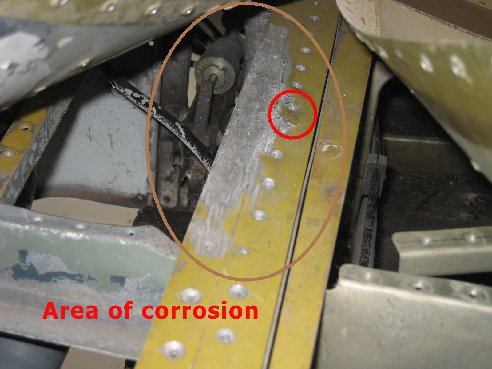

At OSH this year, during the multitude of conversations, chit chats, and just plain eavesdropping, I heard the word "corrosion" in the same sentence with "CJ-6". Of course my ears perked up. I've done a little research and looked into several of the stories. Thanks to Doug Sapp's pretty wife Katherine, providing me with some phone numbers, and the miracle of e-mail, I've come up with enough to suggest that we CJ-6 owners, take time, soon, and do a detailed inspection of our wings. So far 4 CJ-6 (2 in the US & 2 in NZ) have had significant spar cap corrosion.
The two here in the US were inter granular corrosion of the lower spar cap. One, the corrosion spots was located in the center section, in the other, the corrosion was in the left wing just out board of the landing light. According to my source in NZ Jay McIntyre, those aircraft there, suffered heavy surface corrosion due to very poor storage for a numbers of years.

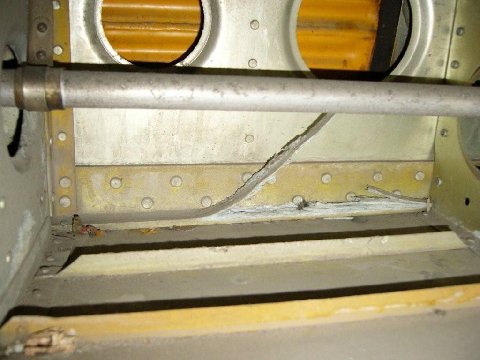

Here is a picture of what Jeff Boulware sent me of the damage he found in his aircraft.
Again this damage on this particular aircraft is located in the bay just out board of the landing light. The corrosion is on the lower spar cap. The yellow object behind the lighting holes in the spar web, is the left main fuel tank. The tube in the picture carries wring going to the wing tip and flux gate compass. Because of this and other damage (see below) he replaced the wing.
Below is the corrosion located on the lower spar cap in the center section of Sean Carroll's aircraft.

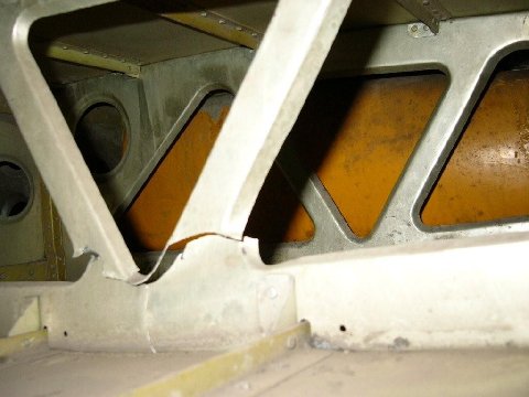

This next picture is again from Jay Boulware's aircraft. Though not related to the corrosion, it does show what other damage could be found during a really good inspection.

The pictures are telling. The last one shows corrosion that would not be detected unless the skin is peeled back. I know many are lulled into the belief that corrosion cannot be a problem on these planes as they are built mostly of anodized aluminum. It may be time to start thinking about very detailed inspections and application of Corrosion-X in the wings.
