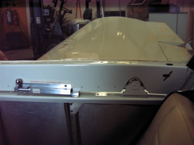

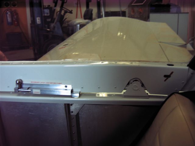

chris Sinfield
Joined: 28 Nov 2006
Posts: 270
Location: Sydney Australia
PostPosted: Sat Oct 18, 2008 7:31 pm    Post subject: Re: Canopy Safety Reply with quote
In Australia
we are recommending in the SAAA and the RAA are making it mandatory for putting in an extra safety latch or cable to all our Zodiac XL's with the older thinner Aero Plastics 80 thou canopy's. It appears that the older 2 stage locking mechanism is easy to not lock properly. This results in it only locking to the first stage and popping up just after take off.
It normally happens on the passenger side, as they don't like to slam the canopy , so lowering gently and not locking it fully.
Don't work , with the older thinner canopy if you have an accident and people need to get into the cabin to rescue you, the older thinner canopy would be easily broken by a fist, shoe or even yelling at it.. (well you would have to yell hard).
We can either have a cable system as Jan's one above or an extra lock on each side of the normal lock. If you upgrade to the newer canopy system you don't need to do this or get a Todd's Canopy as they are 120 thou.
I will try and attach some photos.
Chris.
Sydney
XL Jab3300
sliding lock
 Filesize:  32.56 KB
 Viewed:  751 Time(s)
