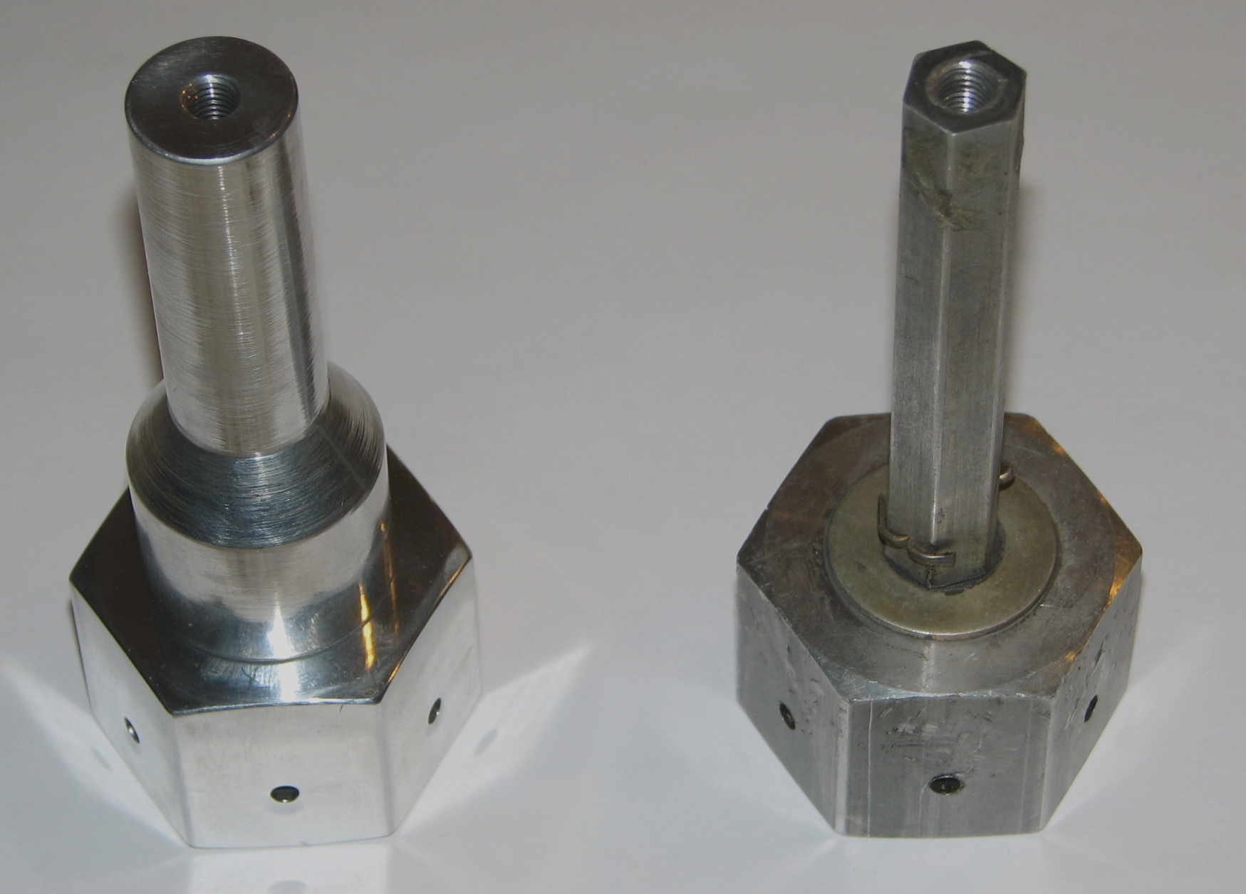

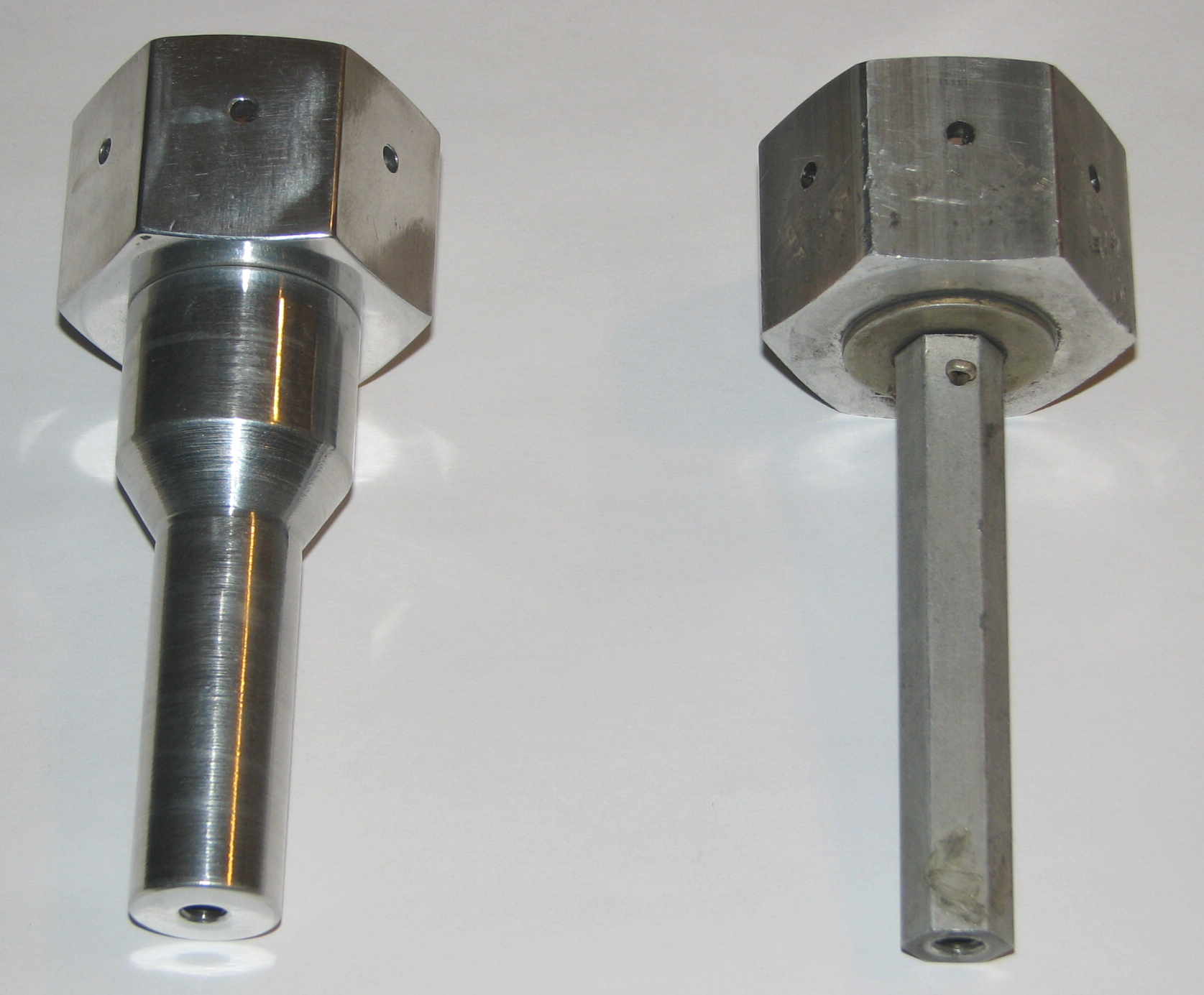

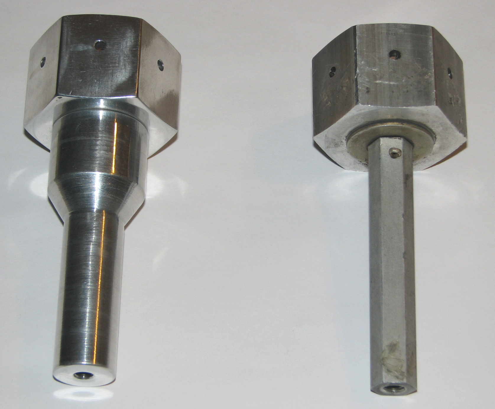

Not sure what most of you have done, but when I saw the extensions supplied with the kit, I knew I needed something different/better. So I machined a new set for myself. Then my neighbor, Mark Carey with a flying 10, told he he sure wished I had made him a set. That was 6 months ago. Last week he called me to tell me that after a hard landing, he broke one of the extensions. So, long story short, I gave him mine, and am now making more. Made out of Aluminum 6061T6, using an AN5 bolt to bolt to the axle nut, instead of the stk AN4. All that's left to do from the user end is drill out the attach hole in the nut, install the AN5 bolt, and drill for a cotter pin.
I am initially making 15 sets and am giving them away for $40 a set including shipping.

I can hardly wait for Ricks question asking me which one in the picture is the one I made!!!!!!

You guys do know that Cleveland Tools stocks these now, right?
So they're available all the time, and all of the drilling is done.
I think they may be $5 or $10 more expensive or something like
that, but just wanted you to know that they are there. Another
builder took that design that I originally made and decided to
build them and distribute them through Cleveland. Nothing
wrong with having multiple sources, but just pointing out that
EVERYONE should really get themselves a set sometime, from
at least somewhere, and Cleveland stocks them. I'm not sure
if they include all the hardware like I did originally, or not,
but I also did include a longer Stainless Steel screw for the
outboard side, because those screws definitely will work themselves
loose if not lock-tite'd in.

same. I'm sure that the Axle extension business will be
continuing good business. At the time when I did the first
group order, there were over 160 pairs that went out, if
I remember right. As far as I'm concerned, this is one
of those parts GUARANTEED to cause problems if you build
it stock....just like people who use the old stainless
spacers on the front axle. If only someone (maybe you're
up for it??) came up with a good retrofit kit that included
anti-rotation stop screws such as this photo I grabbed
off the VAF forum a long time ago:
http://www.myrv10.com/tips/maintenance/NoseWheel/2005087365224441271_rs.jpg
Now THAT is a parts kit that I think would also be a "must buy".
My writeup on that problem is here:
http://www.myrv10.com/N104CD/maintenance/20060809/index.html
Good luck and folks, just email Don directly if you want
his extensions. If you're a newer builder who's completely
uninformed as to the problems with the original extensions,
here's my old write-up:
http://www.myrv10.com/N104CD/upgrades/20070118/index.html
What would be REALLY interesting is to see what Van's reply
would be, if a couple of people who had the standard ones
break called up and said "Have you ever seen this problem
before?" I'd put a couple bucks on the bet that they'd say
"No, we've never heard of that problem." Smile Too bad in the
field, these things have been failing quite often...probably
due to the RV-10 using larger fairings than they were used to.
