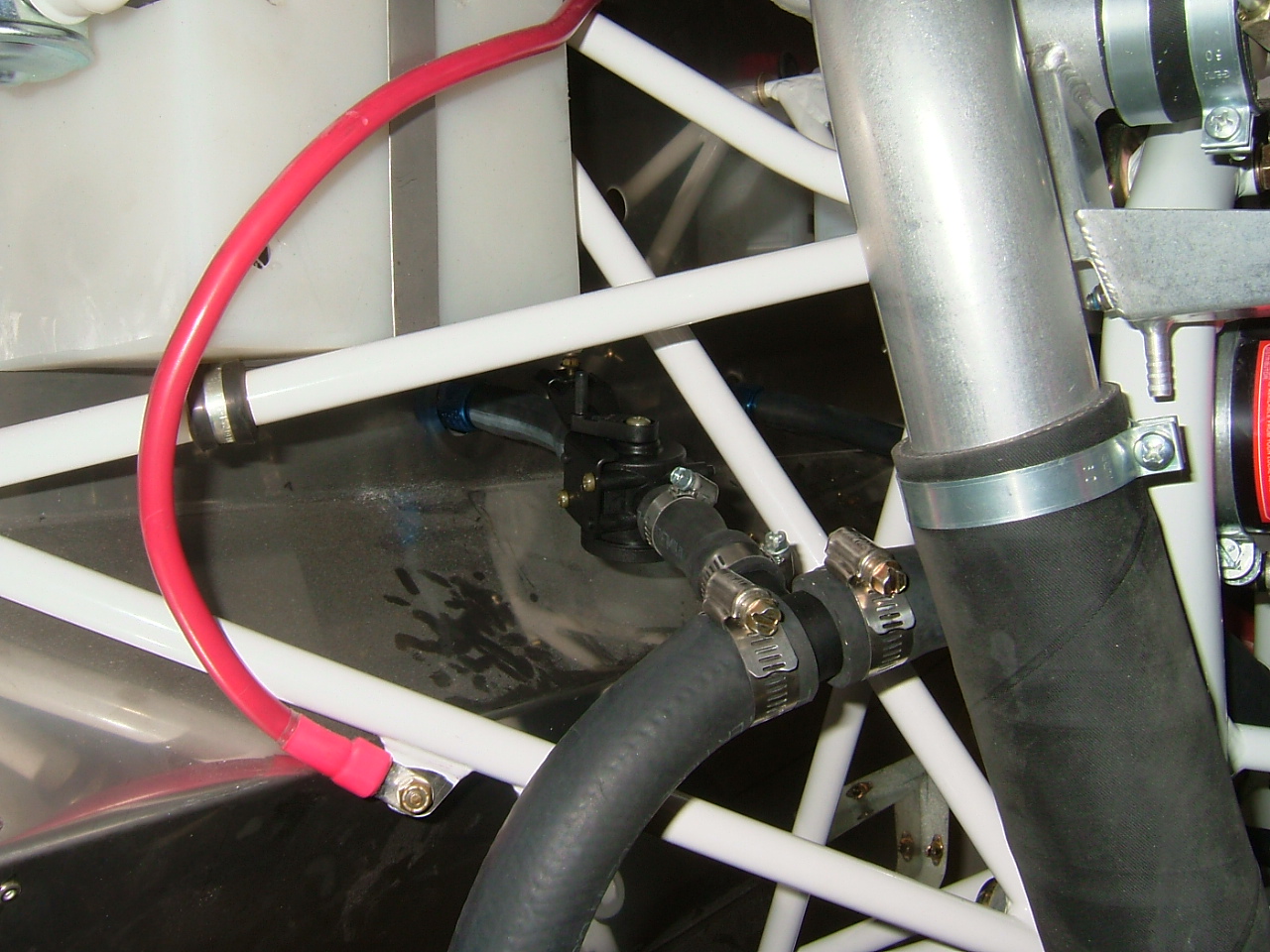

I got the shut off valve and cable from Napa auto parts. I don't recall the part number but it was a stock item and I went through what they had until I found one that fit. It simply closes the heater circuit when shut. So far it has worked like a champ.

I think the shut off valve from Napa ($20?) is probably # 6601141 5/8" with the cable in-line to the hose. Kragen Auto # 74627 sells for around $15. You can see pictures on their Web sites.

I couldn't find the Napa part # on their website but the one listed on Partsamerica.com (#74627) is the exact valve I used. Here is a pic of it from their website and a pic installed in my bird. The supplied 1/2" coolant hose took a bit of coaxing to get over the 5/8" barbed ends of the valve but with a little lubricant they will go on.
