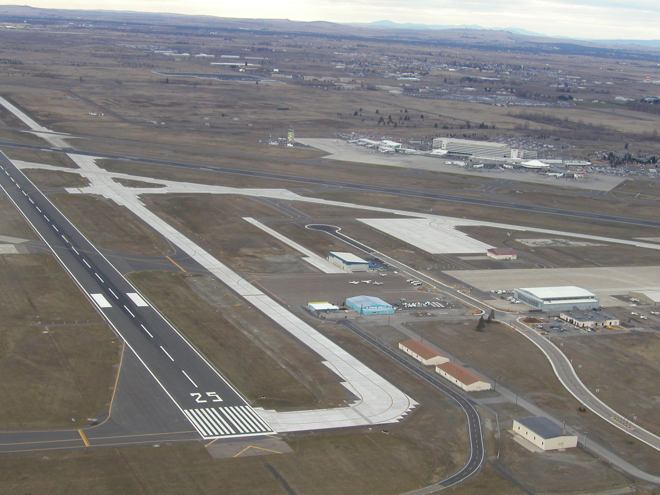

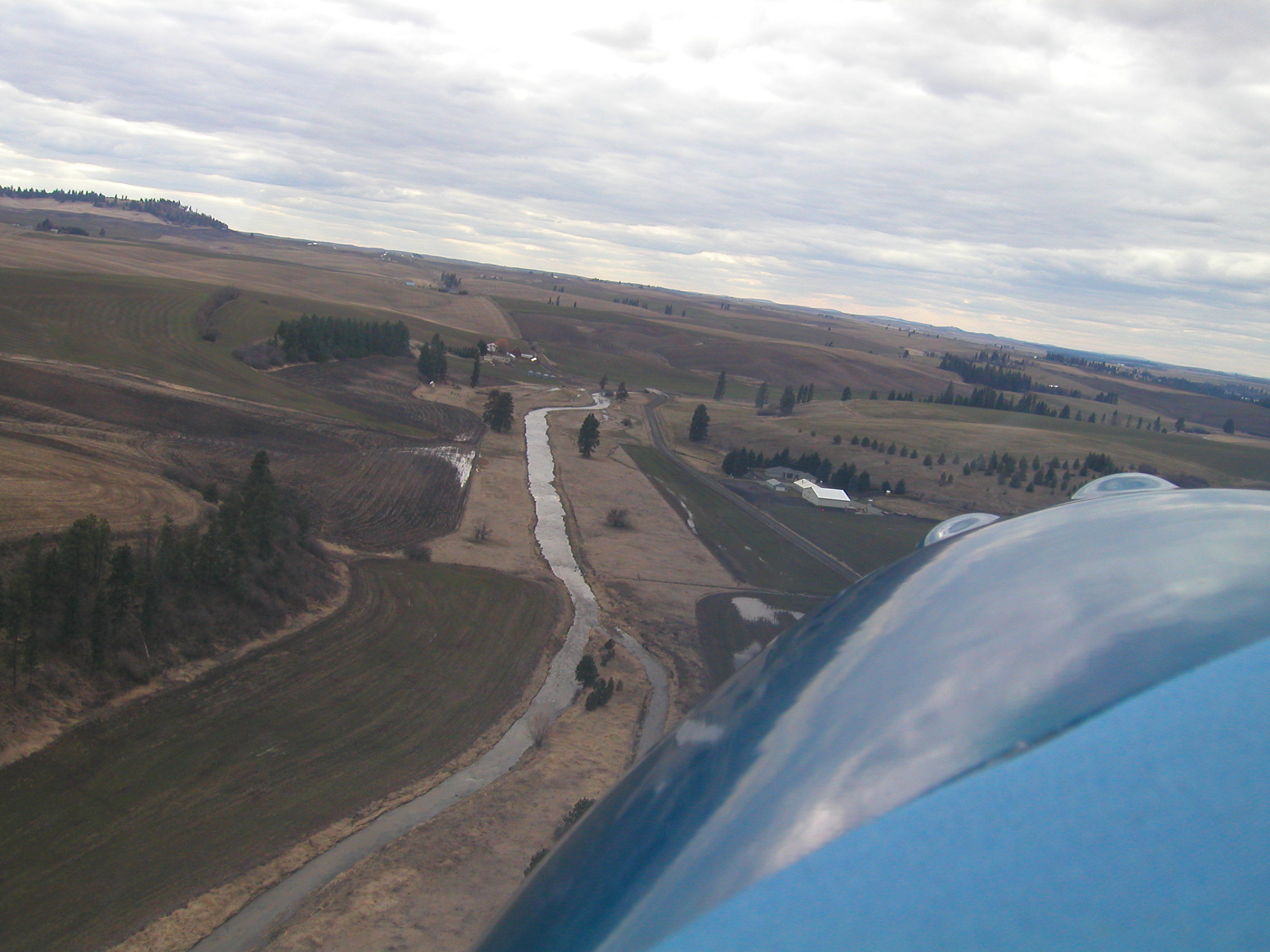

here is a pic of my IFR

f.miles.tcp.833(at)clearw Guest
Posted: Wed Mar 22, 2006 9:34 am Post subject: VNE on a mod 4 1200 and high speeds |
Is that Felts Field?
Frank LWS
| Back to top |
mike Guest
Posted: Wed Mar 22, 2006 9:51 am Post subject: Re: VNE on a mod 4 1200 and high speeds |
no, a farm house about 15mi south. I'll get a pic of felts when I can and post. want to see spokane international, here you go.
Posted: Wed Mar 22, 2006 10:05 am Post subject: VNE on a mod 4 1200 and high speeds |
Excuse me . . .the fifth picture you have posted is no farm house. Must be
GEG?
| Back to top |

mike Guest
Posted: Wed Mar 22, 2006 10:15 am Post subject: Re: VNE on a mod 4 1200 and high speeds |
If you are writing about the pics on the frapper. the fifth pic is fairchild AFB.
