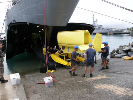

Here is a picture of someone that is actively using the folding 701 option to his advantage:
Complete story on this and many more pics in the next issue if the Zenair Newsletter, mailed in a week or so.

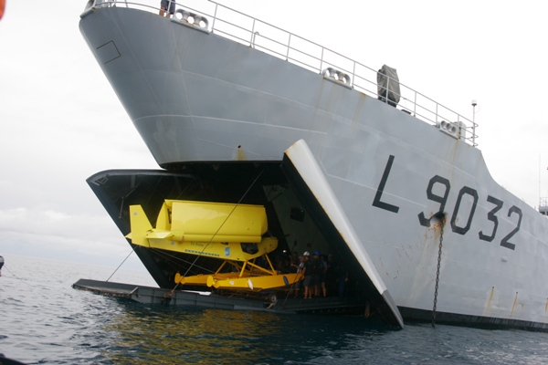

Jon, that sure is a nice hangar (portable) for the yellow 701 on floats!
Looks like there may be a sufficient number of people available to do the fold/un-fold operation.
Sure hope I didn't start the flames.
There was a boatload of helpers!
Note below the dockworkers... but I guess they didnt do the folding. I will try to followup with a story about the effort required to fold/unfold from this guy that has personal experience... I am quite curious also. This 701 pilot is from New Caledonia... now I had to get out my globe to locate that country! The newsletter went to the printer today so by Turkey-day weekend they should be heading out the door... and this issue will include a DVD of contributed video segments from 601/701/801 builders and pilots ! Even I am excited!
