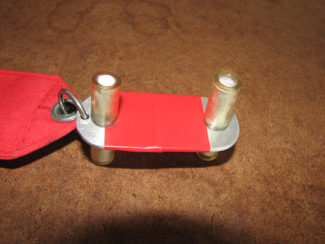

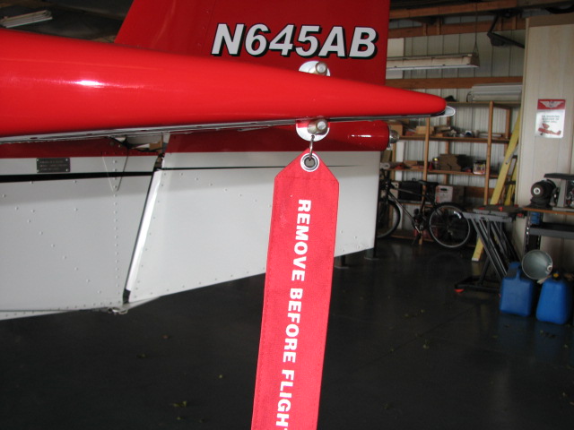

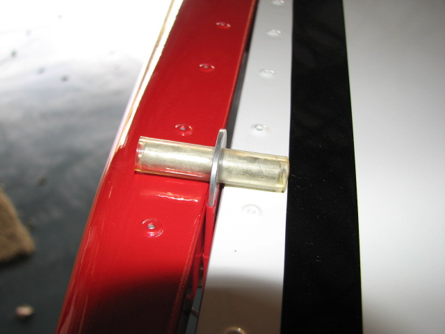

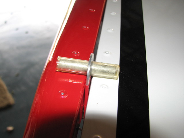

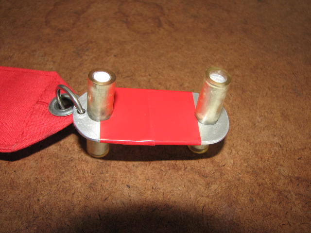

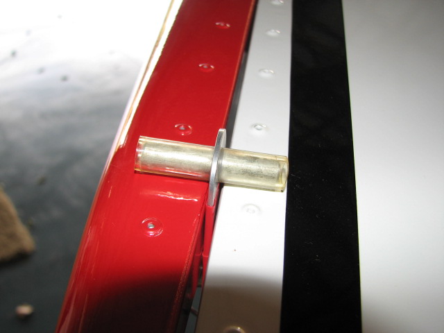

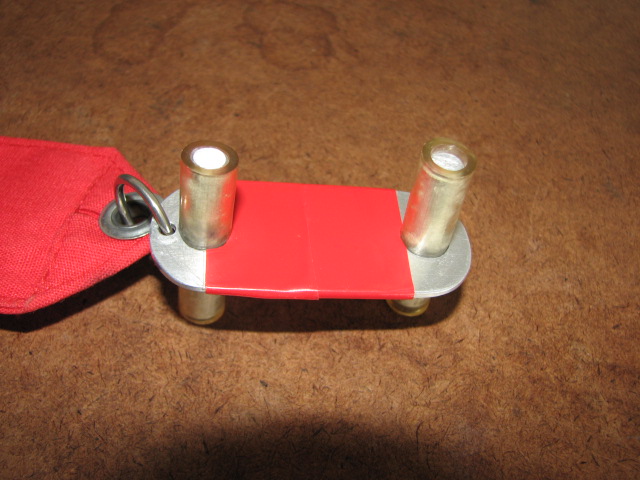

Simple Gust Locks-----(See Pics). Flat Alum., Alum rod, and plastic tubing. Push tubing over rod and drill holes in flat stock (Tight fight) and pushrod with tubing over it through fat plate, add flag and your done.
Al from Oshkosh
