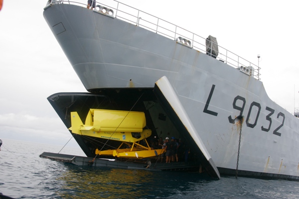

Does anyone have good pictures showing what this is? Some have commented that it is ugly, but the best I can tell from the poor pictures on the Zenith site is that it has a removable bar in the front and a cradle in the back that is also removable. From the comments I've read I don't want it for common storage, but for ground transport.
Here is a picture of someone that is actively using the folding 701 option to his advantage:
Complete story on this and many more pics in the next issue if the Zenair Newsletter, mailed in a week or so.
Dont miss this issue! Subscribe at www.zenair.org
[img]cid:90B8D3096C5240B89F39B01CFF43BA0F(at)JonsPC[/img]

Now thats just cool!
kevin

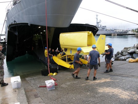

Jon, that sure is a nice hangar (portable) for the yellow 701 on floats!
Looks like there may be a sufficient number of people available to do the fold/un-fold operation.
Sure hope I didn't start the flames.
There was a boatload of helpers!
Note below the dockworkers... but I guess they didnt do the folding. I will try to followup with a story about the effort required to fold/unfold from this guy that has personal experience... I am quite curious also. This 701 pilot is from New Caledonia... now I had to get out my globe to locate that country! The newsletter went to the printer today so by Turkey-day weekend they should be heading out the door... and this issue will include a DVD of contributed video segments from 601/701/801 builders and pilots ! Even I am excited!
[img]cid:2F51047A03AA4DCEA80346CB680A8BB6(at)JonsPC[/img]
