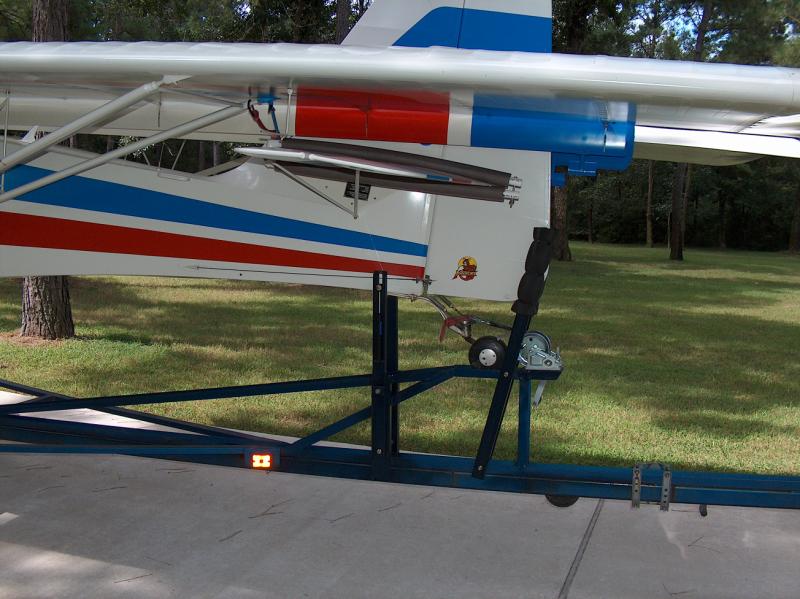

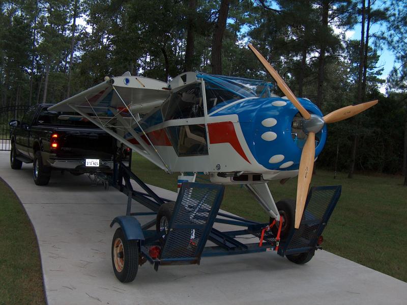

Mine is a Speedster that came with a Skystar factory trailer and brackets. The trailer is single axle with springs and a large toolbox. Two brackets go from each front spar to the landing gear brackets. Two go from each rear strut to the horizontal stabilizer. These secure and support the wings.
I tie the outer flaperon weights together with a bungee. This keeps the flaperons immobile and clear of the horizontal stabilizer. I leave the stick forward, elevators down. I put foam pipe wrap over the rudder and secure it to the wing brackets with bungees, so that the rudder is turned fully to one side.
The tail is supported by a bracket that holds the aircraft on also. So do the ramps, and a motorcycle tie on each landing gear. I only tow it a few miles, but could go indefinitely like that, as everything is secure and nothing moves.
I have never covered the top, but would explore a cover held on with bungees with pads under grommets and hooks, angled out, or tied on with cloth or ropes, using bungees from each tie or rope to the landing gear brackets or trailer as a tensioner to keep the rope or cloth tie tight to avoid flapping.

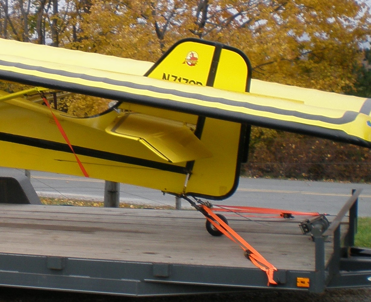

These questions are best answered if you give us a bit more information
James (I assume is your name?). I trailer my Model 2 all the time on a car
trailer and also have the original Denney-supplied tow kit. As I understand
from posts on this list different models have very different towing
requirements.
To start you off I have attached a picture of my KFII tail section ready for
the road, speeds up to 50 mph but that is a self-imposed limit and I don't
have far to go.

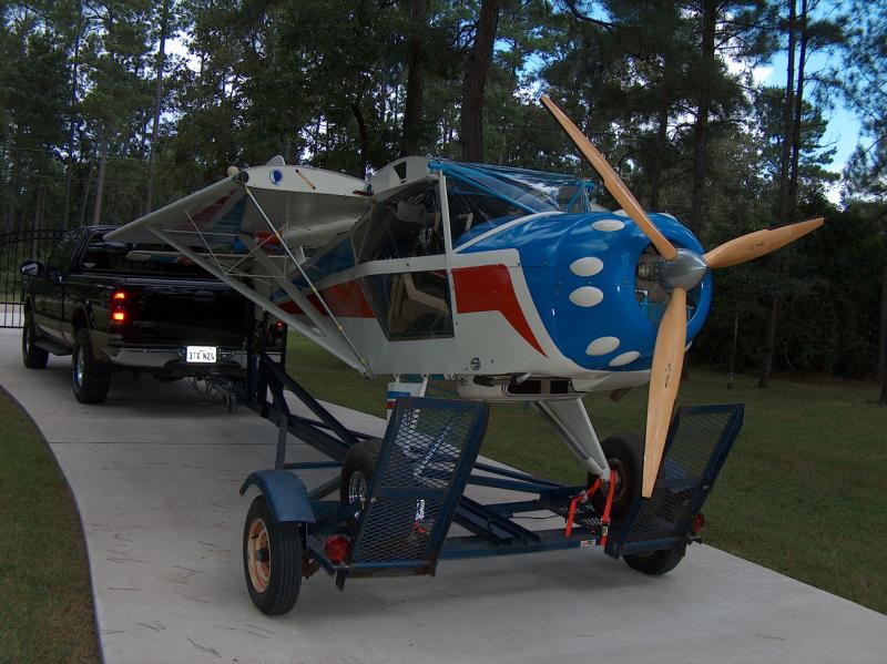

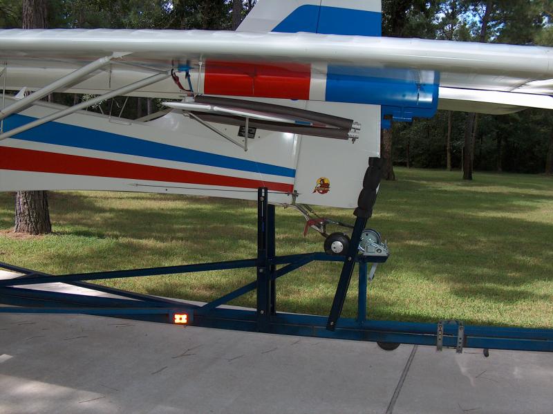

PostPosted: Sat Jan 03, 2009 9:21 am    Post subject: Trailering a Kitfox Reply with quote
James,
The first photo shows the tail wheel support and the second shows the front spar brace that you will need. By the way this is not my aircraft.
David
