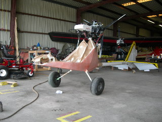

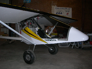

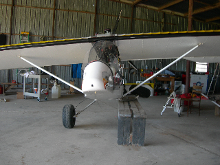

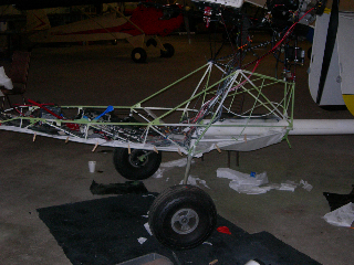

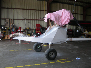

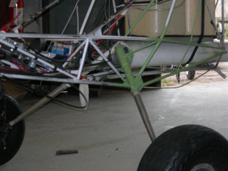

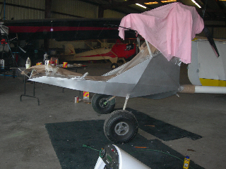

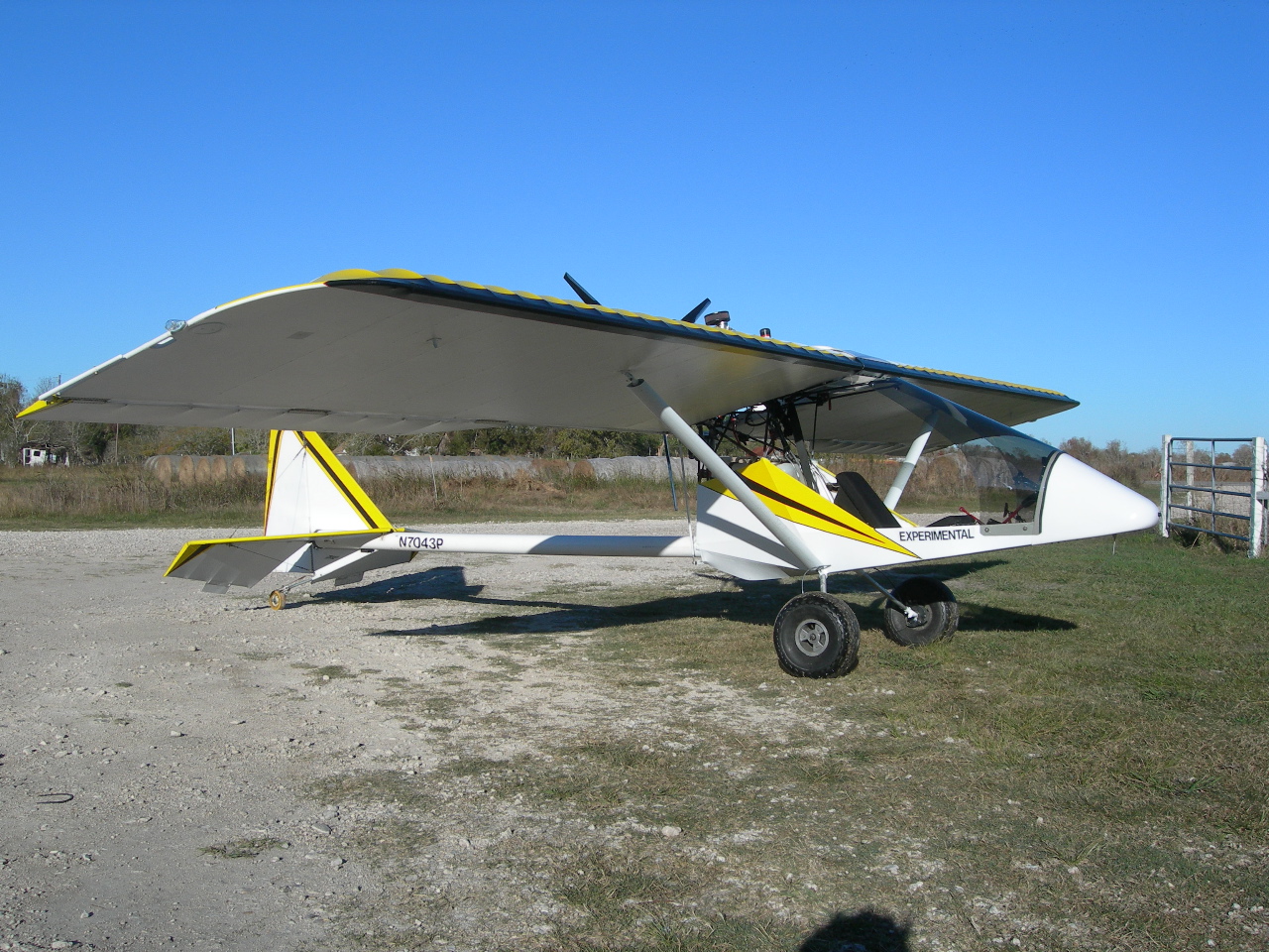

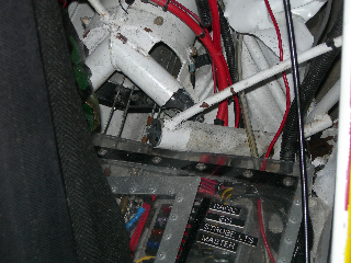

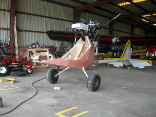

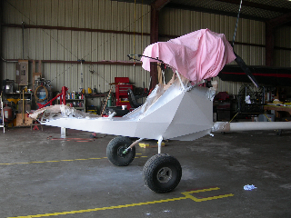

Broke my plane in September with a hard landing. Sheared off the left
gearleg socket where the aluminum gearleg ends. Got the welding done
at an FAA Repair Station shop because I have no welding experience at
all. I did everything else with a little help on painting from my
local flying buddies. Finished it over Thanksgiving weekend. It turned
out nice, big thanks to Danny Still in Angleton TX for teaching me to
finish paint. Here are some pics:
gearleg socket where the aluminum gearleg ends. >
Jimmy Young
Jimmy:
I did that in 1988 to my FS.
During the repairs, we developed 4130 gear legs, extending them all the way
in the socket until they bottomed out at the intersection of the two
sockets. Never had another gear leg shear the socket again, although there
have been many hard landings since then.
Old Kolb designed the system that way. It saved weight and material. It
also created a weak gear leg socket.
Monahans, Texas (West Texas oil fields, where the pumps are pumping.)

Jimmy, I think it looks great.  Doing a nice job yields pride of ownership that an "out of the box"owner will never have.  Let us know what you think of those fat tires after flying it for a while.
BB
MkIII, suzuki G10

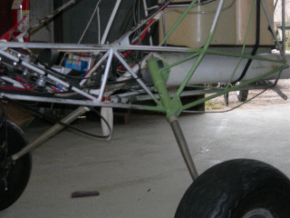

Jimmy Y:
I don't think I did a very good job of explaining my most important point of my last msg. Old Kold designed the gear legs to end at the midpoint of the socket, the weakest point of the socket. That is why it sheared when you landed a little hard.
Didn't take rocket science to figure out pushing the leg all the way into the socket until it bottomed out would spread the load through out the entire socket, instead of concentrating it at the midpoint which is weakest. Acts like a shear.

Jimmy- Looks great, but how hard did you hit? Any other damage? My right leg bent back, but the bend ended at the entry point of the "Y". No damage to the steel "Y". I have the old 1" aluminum legs, and I tried to remove the aluminum bushing. I will probably have to drill or ream it out.
