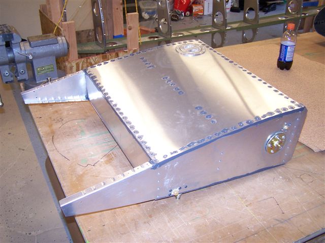

I there any pros or cons to having HDPE tanks made, instead of the AL ones.

Don't get me started. I installed the aluminum tanks but they were a TIGHT fit. In fact I had to put some tapered strips of aluminum on top of the rib flanges, about .050 thick at the critical point adjacent to the rear edge of the tanks, because the tanks were taller at the aft end than the depth of the ribs at that point. If I'd wanted to devote more time to it I might have looked into plastic tanks like those beautiful tanks that come with RANS kits. The other problems with aluminum is there is certain to be oil canning, which may cause the aluminum to fatigue over time. If they ever leak, for any reason, you have to take the wing apart to get them out, a real shortcoming. Maule's have a screw-on cover in the top wing skin for fuel tank access, and excellent idea.

So make the ribs and measure them before I give the guy the dimensions? As I was going to have them made to print, just out of HDPE, well I was going to make them slightly larger along the wing cord, but just a little.
I like the screw on cover idea,anyone hear of this being done on a 701 or should I ask Zenith?

Oh, I didn't know you were scratch-building. I believe I would measure after the ribs are done. I don't know how the screws are secured on the Maule--maybe they just use Tinnerman clips.
Where can you have HDPE tanks made to order?

Yes, I had the same problem. I put 4 tanks in mine, 2 on each wing. I put a sheet of thin cork on the bottom of the wing bay, then tried a tank for fit. I got it in and the it wouldn't come out! No matter what I did! I couldn't believe it, but four of my fellow experienced EAA'rs couldn't budge the thing either! Fortunately it was in the proper place with all the fittings attatched so I just left it there! But I live in fear of it ever starting to leak! I think if that ever happens I'll just use the other tank in the wing and seal off the leaking one.
I had put in two tanks per wing, but would not do that again as I doubt I'd ever have to haul that much gas, but the other tank could save me having to tear my hair out (and the wing apart) to replace a leaking tank!

Kevin, I'll be the first to admit that the Zenith welded tanks are not exactly cheap. They are however very nicely welded and are extremely light. I have mine installed in my scratch built wings and they fit perfectly as per the plans.
I am not familiar with HDPE as a material so I cannot comment as to it's suitability for use as a fuel tank. Are there any issues realted to auto fuel campatability? Also, one advantage to a metal fuel tank is the ability to ground it during fueling. I would also expect that the plastic material would be heavier than the 025 aluminum that the factory tanks are made from. As I mentioned above, the factory tanks are extremely light.
Not trying to throw water on your idea, just wanted to add a couple of things to think about. I personally felt that the purchased fuel tanks were well worth what I paid for them.

On a recent tour of the factory, I had the opportunity to pick up and hold a
completed 701 wing tank. I was amazed at how light it is. It weighs almost
nothing at all.

Yes, they are really lightweight, and despite the trouble of shoehoring them
in, I haven't had a bit of trouble with them! Be sure to get the whole wing
bay ready in case you can't get them out like I did. Your first fitting may
be your last! Hah!

Rotationally molded cross linked PE is widely used in fuel and other storage tanks. HD linear PE that is fabbed from sheets and thermo -welded may be a little iffy. You can get a lot of good info by simply checking out PE FuelTanks. A 1/4 inch wall manufactured tank might be available from regular sources of after market auto products. They do have a temperature limit which may not be a consideration for your use. I'm not sure the PE would be lighter than aluminum though.

Two other options that might be useful pop up in my feeble mind.
For the scratch builders it would be a simple matter to trace out the main
rib form block on a piece of paper and remove 1/8" (or whatever you feel
comfortable with), make a couple of ribs for the ends and sheet over with
025, sealing everything up with proseal. My RV3 tanks have lasted 30 plus
yrs and 2000 hrs with only one leak.
Another thought , I'm giving SERIOUS thought to this , is just making that
wing bay wet by sealing up the ribs, spar, skins, I will put the opening on
the bottom to keep the top lifting surface as clean as possible. Top and
bottom skins will be 025 in this area. Advantages are , lighter, cheaper,
easier to build and will carry more fuel for the space used. Haven't passed
it by my aero engineer buddies yet but considering the fuel was there anyway
I don't THINK there will be much to change, BUT I'm wrong a lot so we'll
see.

Attached is a picture of one of the two tanks I made. I'm scratch building
and made form blocks a little shorter than the wing form blocks. I put a
baffle in the middle to keep the full tank from bulging. I was going to
make the tank deeper but decided I didn't want to mess with the CG. The cap
is an ACS flush mount model. There is an aluminum block in the corner where
the fuel outlet is and the drain plug is also in that area. The vent line
will run up from the bottom in the corner where the cap is (I riveted a 1/4"
aluminum plate and threaded in for an 1/8" NPT fitting). The fuel sender is
the normal one and I got it from an off-road-vehicle supply house. I made a
new ring with threaded holes for the sender to bolt onto and Pro-Sealed it
to the inside of the tank; this was so I could have a larger area for the
sender gasket to seal. There is also a fitting next to the sender for the
fuel return if I go that route (hot fuel system?). Used "closed end"
rivets. I pressure tested it for several days using the balloon method.
The tank is completely enclosed in the wing (not a wet tank system). I put
cork strips between the tank and the skin. I just finished riveting the
wings yesterday (anyone have a cure for hand cramping?).
BTW, I found out that you can clean up Proseal with lacquer thinner.
Curt

Thanks for all the replies, I know it would be heavier then the AL ones, but I don't what to learn to weld AL just for these tanks and I don't want to pay Zenith the asking price for them. I had not considered the grounding issue. What do they do in this case?
I do like the idea of two "Ribs" with pro-seal though, as one of the reasons for looking for something else, was to get about 24 gallons total. 30 years John, thats good enough for me!
Curt,
I really like that tank, what are closed ended rivets? I assume they are not solid rivets, because you would not be able to set the second side. I also assume that you used pro-seal on the joints?

Posted: Fri Nov 14, 2008 6:17 pm Post subject: HDPE fuel tanks |
I got the Closed End Blind Rivets from here:
http://www.hansonrivet.com/w22.htm
The part number is: PASD401H ($58.54 / 1000)
I also got some PASD403H ($13.22 / 100) to attach the flanges.
I think ACS sells something like this too.
Curt

Posted: Sat Nov 15, 2008 9:01 pm Post subject: HDPE fuel tanks |
Hey Curt
Nice tank... good job, I'm scratch building mine also. My tanks will look
just like yours... except for the stub ends. Its nice to see what mine
will look like when I'm done. I'm using 5052 H32 aluminum 0.032 for
tanks... and will also have a baffle. Both tanks will use one 4 x 6 sheet
which is only about $44 at ACS. Since I am making the tanks myself I
decided to make them with the same profile as the wing.
Van's Aircraft... is a good place to get the various flanges(for rivets)
and closed end rivets needed at really good prices. I acquired the
drain(cav-110) flange - VA-112($7.80) with the rivet holes already drilled,
and the closed end rivets AD-41H(1/16" grip) and AD-42H(1/8" grip)
$0.06/per. ACS have the same rivets for $0.18/per... which is nuts. Van's
flanges are already drilled for rivets so it makes it easier to work with,
and are the only place where I could find them. That also goes for the
finger screen flange. I used AN(-4) bulkhead fittings for the vent lines
and return lines.
I was looking at the same ACS flush mounted caps... but not sure how they
can be installed as of yet, have not had time to think about it.
The fuel sender I have is the standard VDO... they wanted $20 for the
install ring and screws... so I made mine out of 1/8 aluminum, very easy to
do.
Again nice tank! If you more photos it would be nice to see the rest of
the tank!
R.D.(Ron) Leclerc
CH701 Plans(Scrap) Builder #7-6699
infow(at)mts.net
11/15/2008 10:45:59 PM
