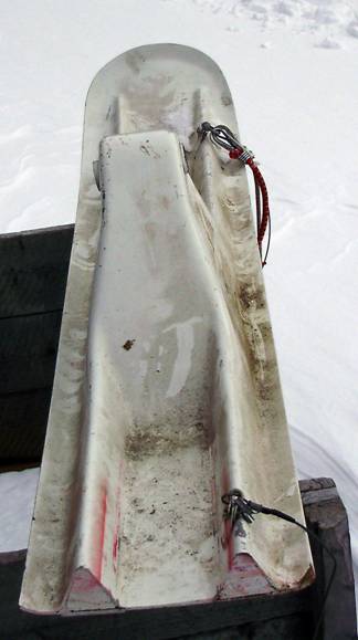

PostPosted: Wed Dec 24, 2008 10:54 am    Post subject: Skis - Solve the "Wide or Narrow" problem...partly off topi Reply with quote

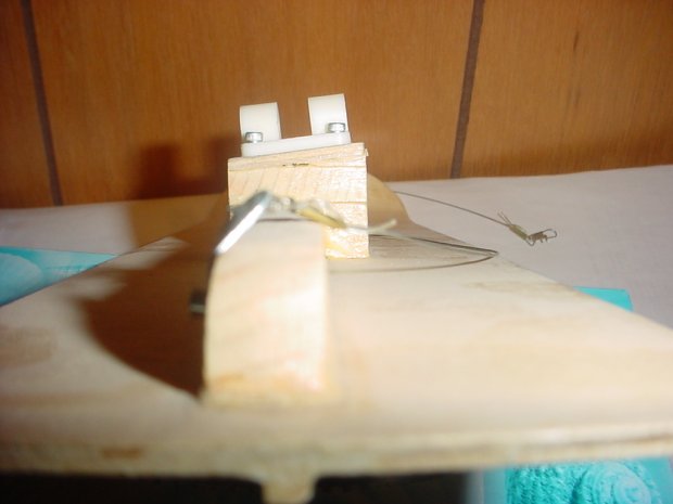

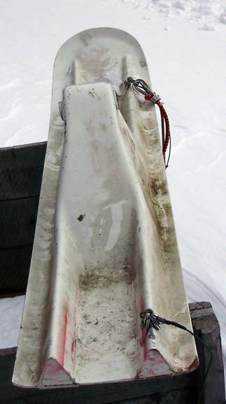

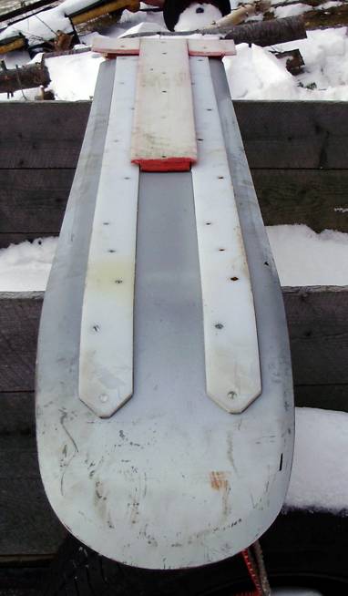

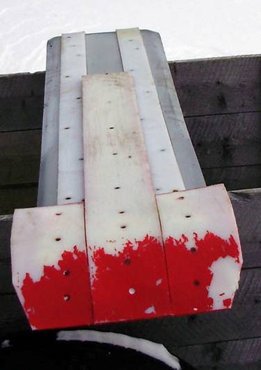

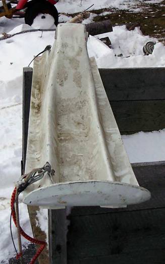

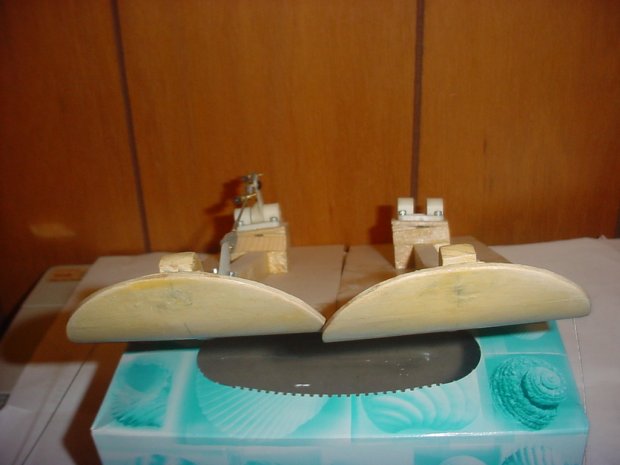

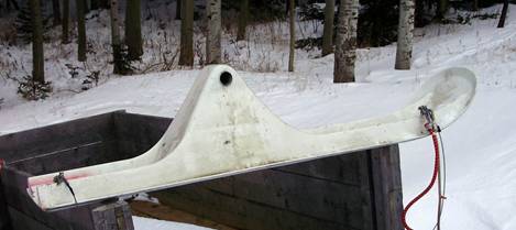

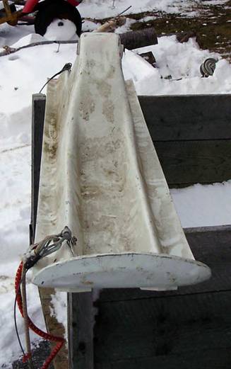

Lynn all this talk of photography is like getting a kick in the duff.  So aI went out ant ook a few "snaps" of my skis The very first one has a perspective that makes the axel look tilted, its not.  Thge reverse inserts may give you a few ideas.
Picture 1.  These skis are no doubt foam cored as they are quite stiff and weigh a lot less than the wheel and tire they replace.

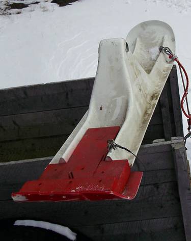

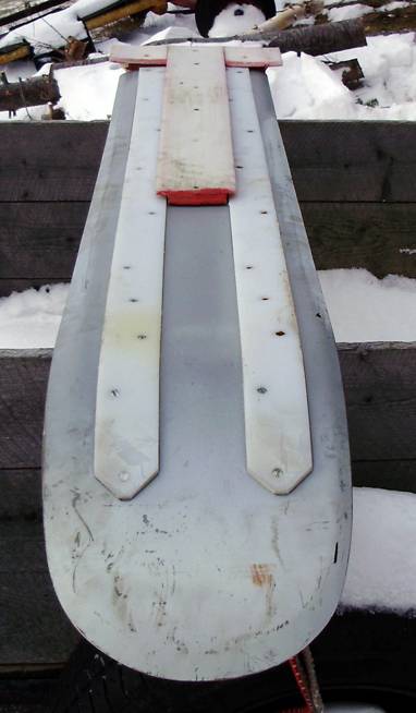

Picture 2. This is the picture I mentioned with the perspective shift on the axel.

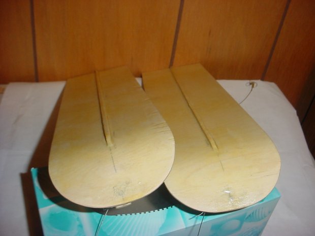

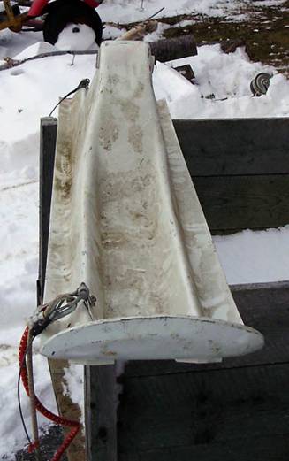

Picture 3. This angle shows the axel is straight and it also shows the two thin Teflon plastic runners on the bottom of the ski.  Notice no whear bars as the skis are not to be used on bare pavement.

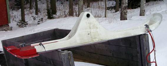

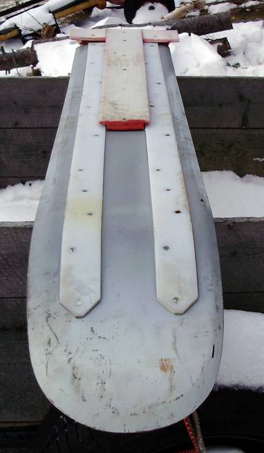

Picture 4.Ski right side up reversing insert upside down.

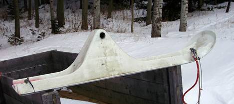

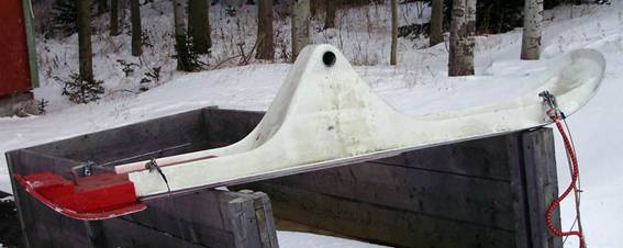

Picture 5.Reversing insert in place on ski.  Insert is held in p[lace by a cmall bungee that goes through the I screw and around the axel. ( retainer is not in palce.)

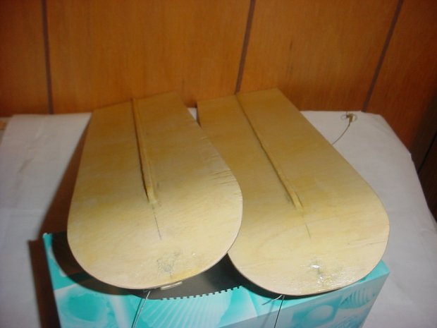

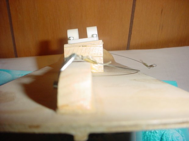

Picture 6.
Rear view of the ski with the reversing insert in place
Picture 7. This angle shows why the reversing inserts should be removed before forward taxiing let alone flight.
Picture 8.  Insert in place taken bottom up from the rear.
All these pictures were almost 2M in size I crop0ped and reduced them for E-mail
What I tried to hide is except for a small drift there really isn’t that much snow around here... Certainly not enough to think about landing in bogs on skis.  No sign of ice this month.. I have an ocean of water outside my door.
Re the length of the skis Longer will get you on top of the snow faster, as there is less frontal area to plough per sq inch of loading area...  but they will also help keep you straight...  this is great until you want to turn.  Wider skis will give more lift on the snow but with the wide frontal area will be harder to get to lift you to the top of the snow.  Wider skis won’t hold your plane as straight as longer skis..  It’s all a matter of compromise.
When I was in high school I used to ski on a set of head 215 downhill racing skis.  Speed and stability were  no problem...
Turning was!  Today the average ski is a lot shorter ability to do fast turns is increased but some of the stability especially in powder snow is gone.
Sorry if the whole e-mail is a bit on the large size for dialup  I think it’s less than ½ MB.
Three guesses how I like to fly ( the first two don’t count)
Merry Christmas
Noel Loveys
Campbellton, NL, Canada
CDN AME intern, PP-Rec
C-FINB, Kitfox III-A
912 almost installed
Aerocet 1100 floats

Are you sure the axle mount is not tilted, Noel? I have an author's
write-up for mounting Federal skis A-1500A through A-2000A, and in it
is the mention:
"How many ski fliers using Federal skis know that there is a right
and a left ski? I was always under the impression that the skis were
interchangeable from side to side. This is definitely not true!"
It goes on to say (and this is written on a drawing from Federal
Instructions):
"Inspect your ski pedestals carefully to determine the left and right
ski. The high side of the pedestal cross tube is always placed on the
inside."
In looking at the drawings of the Federal skis, Noel, there is
definitely a high and a low side, just like your skis appear to have.
I'm not saying that yours do, but it might be worth looking at again.
After all, there might be some compensation for camber built into
your skis....Federal seems to have done that in the ski that these
instructions pertain to. Another caption reads:
"To compensate for the camber of the landing gear, Federal Skis are
made Left and Right. The high side of the pedestal cross tube must be
placed on the inside of the gear."
If your axle aren't tilted, it appears that the ski was built so that
a tilted axle insert could be done.
Noel: I really like the reversing inserts! That's a neat idea.
Definitely want those puppies off, when you go forward!
shift on the axel.
Picture 6.
them for E-mail

PostPosted: Thu Dec 25, 2008 11:24 am    Post subject: Skis - Solve the "Wide or Narrow" problem...partly off topi Reply with quote
You are right Lynn...
There is a left and a right ski.  We used to do that when we were building skis for our RC models.  The pedestal was always higher on the inside and canted the ski up about 10 degrees on the outside edge.  In the enclosed photos from my 15 lb Beaver the skis are 3" wide and 14" long. I used 1/8" plywood and sanded to nothing on the outside edge of the pedestal.  Also used a 1/8" x 1/8" spruce spine on the bottom for directional control.  My tail ski was 3" long and 1-1/2" wide with the 1/8 x 1/8 spine also...
View showing the left and right pedestal as viewed from the front...
Rear horizontal level view of the left ski with the outside of the pedestal 1/8 plywood sanded down to zero...
Hope these photos are clear enough...
R.D.(Ron) Leclerc

If your Federal skis don't have the hole in the pedestal at an angle then
they are made for an Ercoupe. I have seen several airplanes with 2 left or 2
right skis on them. Also left and rights put on backwards. On Federals the
tag is on the low or outside side of the ski pedestal. I have a set of the
Federal 1400's on my Champ. They are shorter and wider than the old 1500's.
I have had both and like the short wide ones better.
