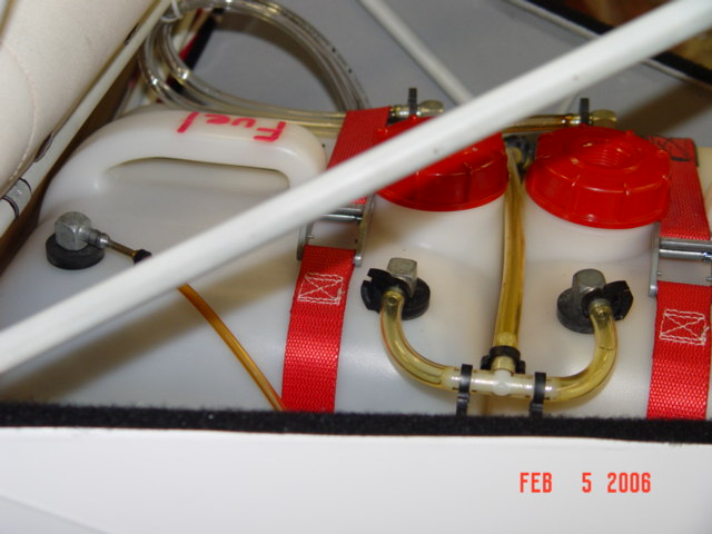

planecrazzzy
PostPosted: Fri Mar 24, 2006 2:21 pm    Post subject: Re: Gas tank pick-up Reply with quote
FUEL "PICK-UP"..........Mine are FRONT and REAR - "LEFT Side"
Because most "patterns" are LEFT
Gotta Fly...
Mike in MN / N381PM
 Filesize:  58.61 KB
 Viewed:  599 Time(s)

Thom Riddle
Posts: 1597
PostPosted: Sat Mar 25, 2006 6:39 am    Post subject: Re: Gas tank pick-up Reply with quote
Two fuel pick-ups?
Unless the fuel level is above the fuel pump having two fuel suction lines will not gain you a thing. If the fuel level is below the fuel pump, when one of the two pick-ups is exposed to air, air is all your pump will get. This is why on low wing airplanes like Piper Cherokees, there is not a BOTH position on the fuel tank selector, but is on the high wing Cessnas where the fuel pump is gravity fed.
If you don't believe this fill a glass half full of water (or Scotch if you like) and suck on two straws simultaneiously with one below the top of the liquid and the other above the liquid. You'll never get drunk doing this but you might hyperventilate trying.
Of course if you have a submersible pump like in the bottom of water wells, then this is of no consequence.
Thom in Buffalo

planecrazzzy
PostPosted: Sat Mar 25, 2006 9:17 am    Post subject: Re: Gas tank pick-up Reply with quote
Hey Guys,
Yes, I'm not really happy with my fuel pick up system, Later I'll probly try the system where the vent is in the second tank.....The only thing that I don't like about that is drilling a hole in the bottom of the first tank.... But then again.... I do want to add a drain cock on the bottom of the tanks....Somethin like the one Paul Petty put on he Kolbra....
But I've been on the look out for a fitting that will allow the very bottom to drain..... I might have to make something...
Plenty of time for improvements....
Eugene Zimmerman
Posts: 392
PostPosted: Sat Mar 25, 2006 11:31 am    Post subject: Gas tank pick-up Reply with quote
One thing I like about that system is that it requires no holes in
A drain cock in the bottom of the tanks may be a good idea if a
fitting can be installed that actually drains the very bottom. All
the fittings I've seen used on these poly tanks stand up inside the
tank preventing the very bottom from draining.
What I like about a tank without a bottom hole is that it can easily
be removed periodically for complete clean-out.
