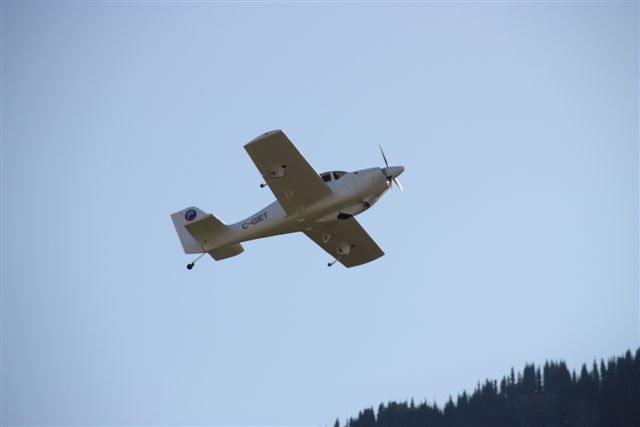

I also recently finished and installed fairings for the main wheel and have flown with that installation for a few hours. It turns out, that there is lots of room for a landing light in the forward part of the fairing, which is attached to the swinging arm. I have made moulds for the two-part fairings and could produce the moldings for interested parties.
