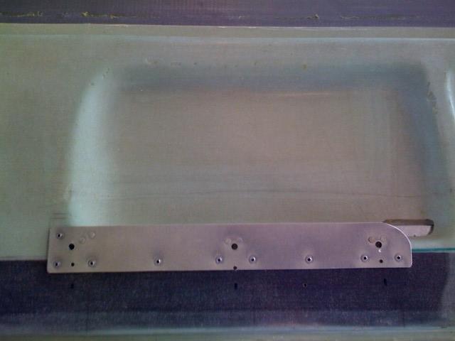

My armrest are larger than normal armrests. I need a solid attachment of the armrest to the door. I thought about rivnuts and epoxing aluminum inserts in the door. I came up with a simple attachment that is very solid for my armrest. I used a scrap piece of aluminum and attached three nutplates on the back side. Dremeled clearance holes in the door for the nutplates. I then expoxied and flush riveted the aluminum piece to the door. I plan on adding a strap in the middle of my door below my armrest for pulling the door down and shut when latching the door. This attachment provided me with a very solid attachment point.
Greg...

Werner
Michael Wellenzohn wrote:
| Quote: |
Thank you for all your answers!
One questions remains open though, if I just have lets say a 3/16 hole how will I get epoxy/flox through it to make a nice base in the inside of the door. Just pressing it through the hole won't do the job.
Michael
RV-10 builder (engine, prop, finishing)
#511
http://forums.matronics.com/viewtopic.php?p 22957#222957
| Back to top |
pitts_pilot(at)bellsouth. Guest
Posted: Tue Jan 06, 2009 5:24 am Post subject: How to create epoxy threads |
I use an allen wrench in place of the bent wire ...... If I can bend the
'L' in the wire without it cracking, it doesn't seem to stand up to the
torque.
Linn
Werner Schneider wrote:
| Quote: |
Hello Michael,
depending on where it is and what load you want to spread onto the
shell you can do following approach to create another hard point. Lay
the shell onto the back, drill your 3/26 hole, use a L shaped hard
wire, where the shorter leg is around 1/2 inch long, use your drill
fix the longer leg in the chuck. Enter through the 3/16 inch hole and
start your drill, the short leg will remove the foam between the inner
and outer shell, move it up and down to get all of it removed and blow
it out with dry air. You know created a 1" hole between the shells
which you can fill with the peanut butter (flox-epoxy) push it in
there and let it cure. This large hard point can hold up quite a bit
of load.
Let me know if you need a hands on, was close to your shop December
30th and missed you there ;o)
Werner
> <rv-10(at)wellenzohn.net>
> Michael
> #511
