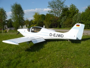

Dear All,
last November I bought D-EJWD, a Europa Classic Mono with Rotax 912 UL.
Since the headroom is definately not sufficient with cussions installed just thick enough for a comfortable seating position (for max. 2 hour-flights) - I am looking for those bubble doors I have seen on few UK-pictures on europaowners.org.
Where are they from? Did aerodynamics change with installation? Are there any other options of getting more headroom easily?
Thanks for a hint or two.
Frank Kusserow

Try using a cushion out of memory foam. You must be very tall.

They were available from the factory as an option at one time. I don't know if they still are. Check with them.
Here in the States, the plexi was provided by LP Aero Plastics, Inc. That's where I had to go for my windows when Europa when bankrupt. I don't know if they would be your first choice as the shipping would probably be expensive. But if you can't find them anywhere else contact:

If you are totally commited to getting the extra head room with the bubble door "glass"
you might try taking the doors off and gradually and carefully heating the offending area with the door upside
down and allow it to sag under its own weight. then let it cool and replace the doors
Of course this approach would only give you an extra 20 to 30mm. This way if you are happy with the
result it has cost you very little, and if you wreck the "glass" then you can still go ahead and replace it
as you first intended.

You will wreck the Plexi if you do that. It reverts to it's "memory
state" when heated above 130C, ie flat but bent. It will shrink
Graham

thanks for the Ideas. I cut into the seat base today and found an inch or so
of styrofoam which I will remove before I get to the windows (because it
might still be not be enough headroom). I am 185 cm (73 inches) tall and up
to now I barely fit into the cockpit. Is that normal in the "Classic"?

There must be more foam or other packing in that seat area or
exceptionally thick seat cushions. I am 6 ft (72 in, 183 cm) tall and
I do not have any trouble fitting in my XS with standard Europa seat
cushions. I still have, at a minimum, another 2 in (5 cm) of head
space.
Work more with those cushions before you go to the trouble of
replacing the doors/windows.

Contact Europa in the UK and we can arrange the bubble glass. I installed it in my first Europa. The glass is from LP Aero in the US. Cost was slightly higher than the original glass, but for you in Europe, shipping will be nearly as expensive. There is no speed penalty to speak of and no turbulence. I enjoyed the ability to look back farther and have another inch of headroom with my too thick cushions installed.
I now have a tri-gear Classic with original gold glass. I am 70 inches tall and it sounds like you have a high sitting height. Normally, leg room is a problem in the classic for folks of your height. Do follow the suggestions offered by the others such as: First, look to cut down the blue foam under the cushion flat with the torque tube cover running down the center of the seat floor. Then, remove the rear cushion and see how the headroom is. You can gain a lot of comfort by leaning back and making the back cushion thinner. My lower cushion is only 1.5 inches of foam hollowed out in the area where I sit to about 1 inch. How I do the hollowing out is open the lower cushion and carve out some of the foam from the bottom of the foam pad until I get my butt where it needs to be and still have adequate tailbone cushion. Be sure to leave the upper part of the foam cushion intact, so when you get out of the plane, the cushion springs back to shape. My back cushion is 1 inch at my back and to the top of the headrest. Where the seat back area goes vertical to the floor near the pins my cushion fills the void and bows out to fill the gap in my back and give lumbar support. This gives me nearly 2 inches before my head hits the glass, if I lean a little right, nearly 4 inches of head room. Finally, a headset with the thinnest pad is a must for a guy as tall as you.

you might try sitting on a small bean bag, shuffle until it's
comfortable then have a look at the shape you need. The trick is to
achieve even seat pressure on the body. Racing cars fill a bag with pour
in place foam and let it set round the body. Has to be the right amount
though.
The problem is sometimes length of upper torso. Body length varies a
lot, You can increase space by moving the buttocks forwards, which will
raise the knees.
I did modify one Europa for a guy who was 77in tall.

I suggest you also try to put more cushion on the lower back of the seat to get a more reclined position. The upper portion of the seat back should be as thin as possible. Moving your bottom forward will increase your head clearance. However this will also reduce your leg room.

If you have long body/short legs this will work well. I cut out the
thigh supports and rebuilt them shaped to fit buttocks. Very comfortable
and only needs thin cushion, (but bean bag is the best, you can change
position and still have even pressure)

One comment on tempur foam. We had it in both our seat bottoms and the back, where the lumbar support is. On longer trips, we both had some back pain. We discovered that the carefully placed lumbar support was going away because the tempur foam was relaxing over time (due to body heat?). We replaced the tempur foam at the seat back with regular upholstery foam, which solved the problem. Of course, we left the tempur foam in the seat bottom to provide the crash protection it provides.

I concur with Karl, try memory foam. Additionally, I found the design of the seat bottom
and seat back to be critically important if you are to fly more than a couple of hours at
a time. I am 6'1" (186cm)and am able to fly 4 hour legs without complaint. The key
for me was to have a semi-reclined seating position with good lumbar support. This is
achieved by having the seat back follow the angle of the head rest (rather than have it
flush vertically against the cockpit module. This puts the bottom of the seat back
cushion around 4" or so from the back of the cockpit module. The seat bottom is
made from tempur foam utilizing two 1" thick plys of foam (one blue and one green).
I have posted a few pictures on the builder forum.

Dear All=2C
last November I bought D-EJWD=2C a Europa Classic Mono with Rotax 912 UL.
ropaowners.org.
Regards=2C
Frank KusserowEuropa Classic Mono
Essen/Germany

Frank
Don´t know if it works with a Classic, but Ian Rickard developed a mod
for the XS to move the ¨step¨at the rear of the rudder pedals about 40mm
forward to the tufnel blocks, thus increasing the leg room.
This would recover any legroom lost in moving the seat bottom forward.
Lance Sandford (only 6´ 2¨)
Remi Guerner wrote:
> Frank,
> room.
> Regards
> Remi Guerner
> F-PGKL
Frank
comfortable and only needs thin cushion, (but bean bag is the best,
you can change position and still have even pressure)
Graham
johnfcliff(at)googlemail.
PostPosted: Wed Jan 07, 2009 4:24 am    Post subject: Bubble doors Reply with quote
> Frank,
don't know if they would be your first choice as the > shipping would
When these door glasses appeared in 2002 I spoke to Andy Draper about
them. They came from LP Aero, there was no UK supplier and no obvious
intention [or need] to get one.
See http://www.users.waitrose.com/~jcliff/Mods/bubble.htm [though of
course the factory is in completely different ownership now.]
John Cliff
