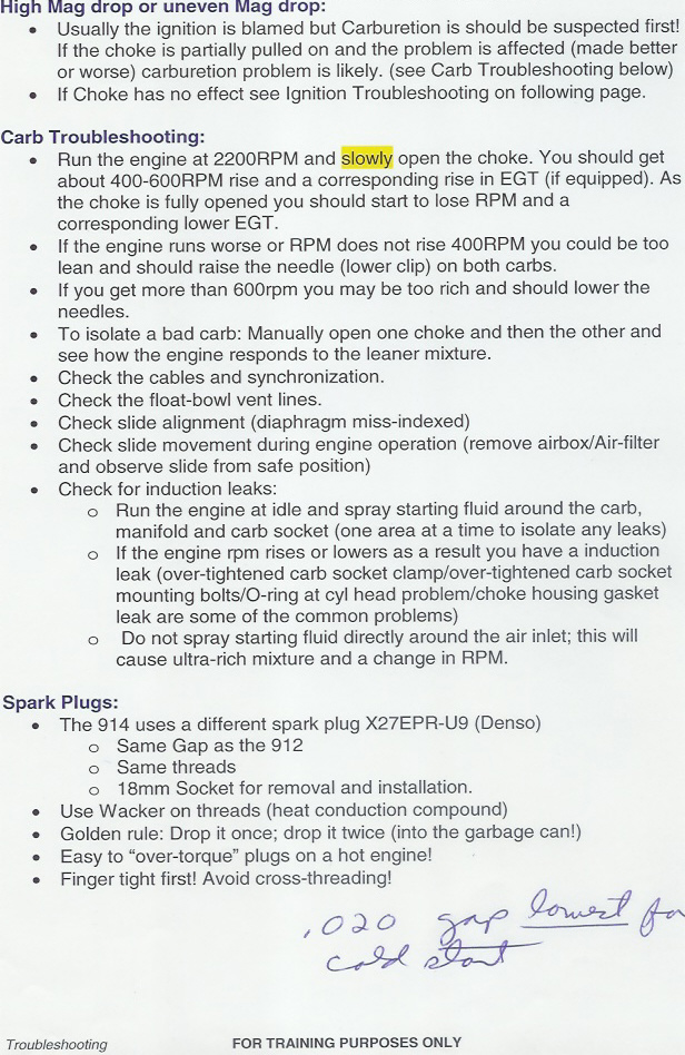

I attached a section on troubleshooting the carbs.
This is from a class I took from Rotax on the 900 series engines, I hope it proves useful.
Jerry

I sent a troubleshooting idea under separate cover. However I would look for induction leaks at the hoses connecting the carbs to the manifold and the turbo to the air box hose. I replaced my hoses at the carbs with the new Rotax designed hoses and clamps after I had a leak that I couldn’t see. I didn’t have as much of an issue as you but I did have some rough spots that went away with the new hoses and clamps. The trouble shooting idea has an affective method of checking for leaks. Good luck.
Jerry
