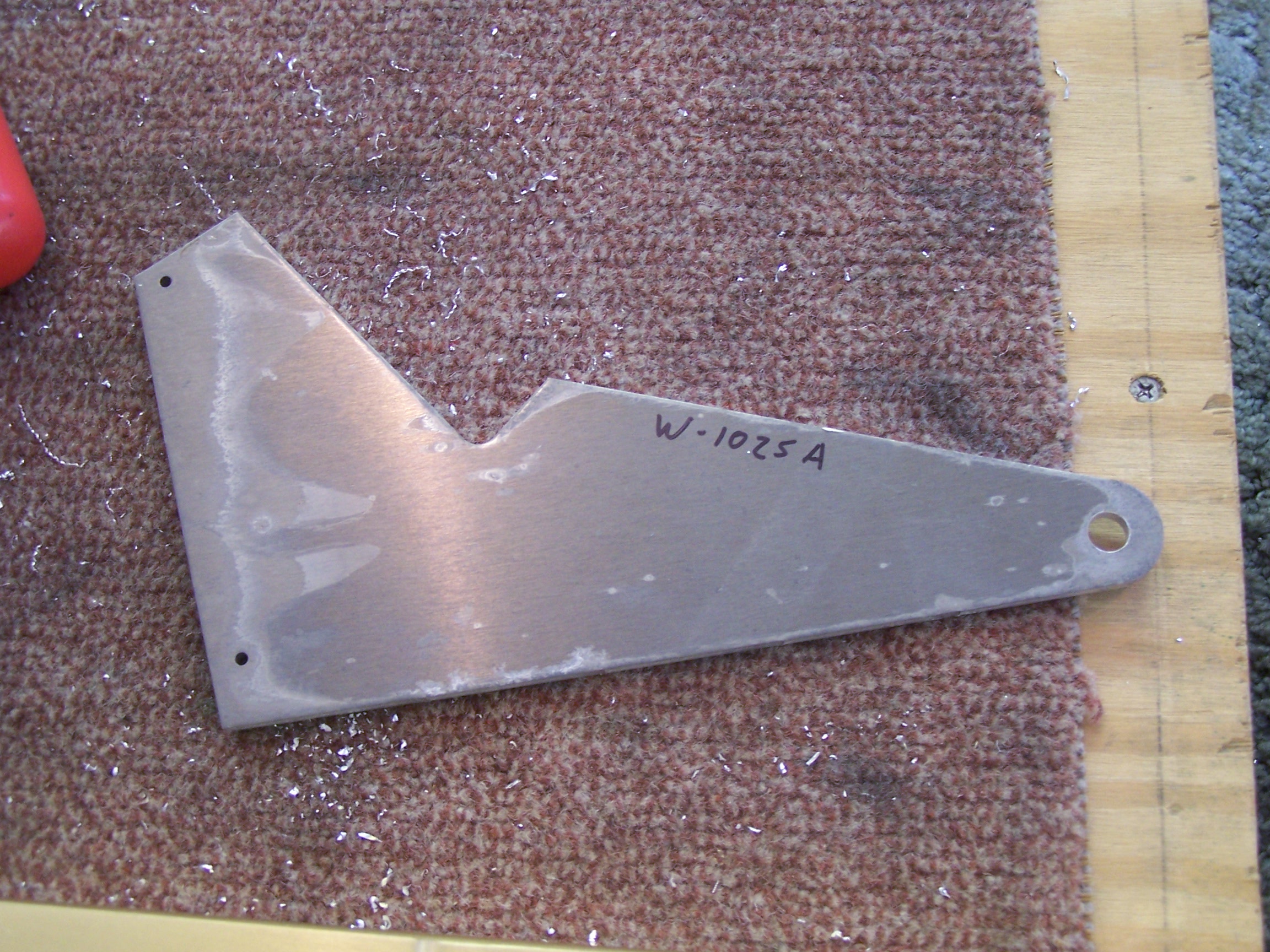

Finally got around to wings and found what looks like corrosion on some of the W-1025A flap hinge brackets. If it's corrosion do I need to worry about it and replace the parts or clean and prime them somehow??? I'll send pics to Vans also to see what they say.

Bill,
It looks like corrosion but not on a large scale, I suspect that there may have been some corrosive chemial stored nearby in the garage/workshop? It would take water quite awhile to develop the pitting I see. Pool chemicals, fertilizer, pesticides etc in a oxygen/moisture enviromet will create an acidic atmoshphere that will accelerate the process. Just my $1.25 worth, heres some info from the U.S. Army's corrosion identification and abatement course. I did'nt include all the forms just the ones that would be applicable to bare metals. Filliform is another fun topic.

Bill,
My suggestion is to take a scotchbrite pad to it until whatever that is is gone and the surface is smooth. Clean it up with some coleman fuel or acetone and shoot it with a bit of primer. Unless that runs deep in to the part, I don't think you've got a problem.
Jeff Carpenter

william(at)gbta.net Guest
Posted: Fri Jan 16, 2009 9:05 am Post subject: Is this corrosion?? |
Thanks guys. Ken from Vans says to clean it up and prime it. It was mentioned that I must store chemicals in the garage to create a somewhat "acidic"environment but in reality I don't store any chemicals in there. The blue "wrap" from vans was peeled off where the "corrosion" took place.

planesmith(at)hotmail.com Guest
Posted: Fri Jan 16, 2009 10:02 am Post subject: Is this corrosion?? |
Bill C
If you have Alumiprep and alodine these are good to use. The etching and conversion coat process will stop any corrosion that may be missed by the Scotchbrite.

Kellym
Joined: 10 Jan 2006 Posts: 1706 Location: Sun Lakes AZ
Posted: Fri Jan 16, 2009 8:50 pm Post subject: Is this corrosion?? |
Have you cleaned with acetone? Frequently the blue vinyl leaves adhesive
behind that looks like white residue. If not adhesive, probably fine
scotchbrite will clean it right up.
Posted: Fri Jan 16, 2009 9:08 pm Post subject: Is this corrosion?? |
Haven't tried anything yet but will in the next day or two. Too busy
