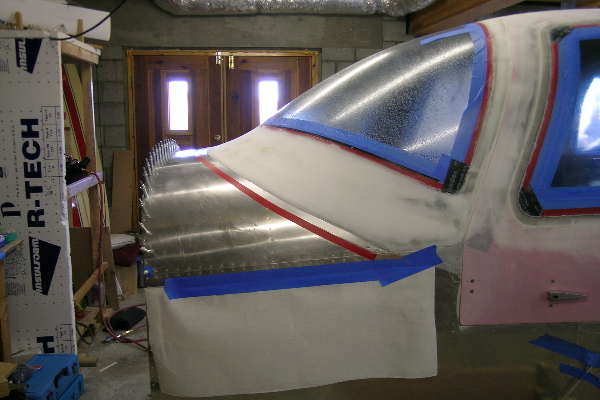

My windscreen faring is about 1.25" taller in both dimensions than plans build...by accident. Hopefully with the number of laminations and the greater coverage C mine will not separate. Notice there is a foam core buildup followed by two more layers of 9.0oz satin weave...no wonder I have so many hours into the project and I still don't have the engine mounted.
The first photo shows the amount of fiberglass overlap on the windscreen. It may look like the visibility is hamperred C but really it isn't.
JOhn
