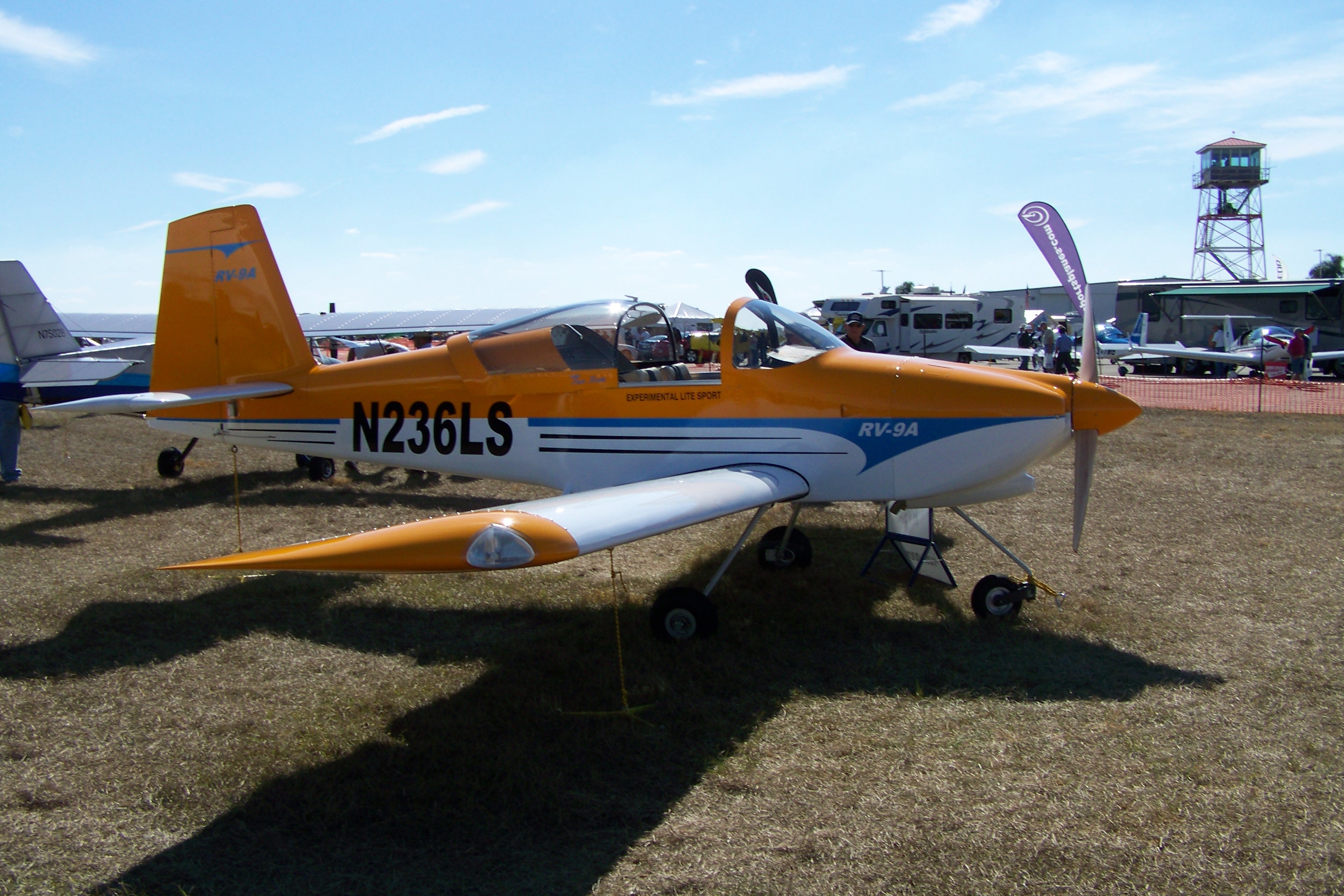

Saw an RV-9A being promoted as a Light Sport at the Sebring Light Sport Expo. The plane had a Lyc. 0-235. The numbers don't seem to add up to qualifying as an LSA. Anybody seen this? Doesn't seem to leave much room for payload.
for payload.
RV had a display across from Zenith (at) S&F last year, and made me this same
pitch, probably because I stated I was interestewd in the Zenith as an LSA.
It struck me the same way. I think trying to make an LSA out of an RV9A is a
bit of a stretch.
Of course, one wouldn't need to worry too much about overstressing the
aircraft, if one were somewhat over the 1320 lb limit. It might tax that
O-235 a bit, though.

PostPosted: Sat Jan 24, 2009 5:19 pm    Post subject: RV9- Light Sport Reply with quote
Van's lists, for the RV9A, with 115 HP, at gross, cruise 55%, 8.000 ft, 148 mph; stall speed 48 mph. I really don't see how an RV9A could ever qualify as an LSA.
I also question the "E" in E-LSA. (ie. the RV12) To qualify, one must be built EXACTLY like a production model of the same airplane. That completely rules out experimentation. Isn't that what the "E" stands for ?
