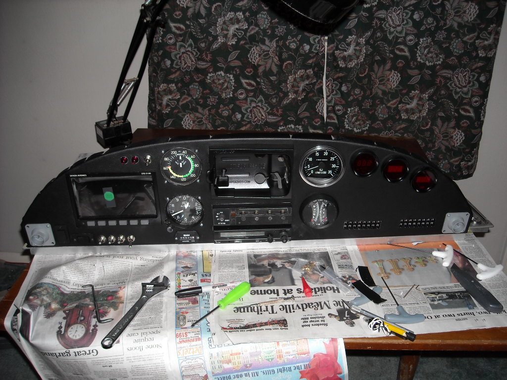

Does anyone have pictures of their old-school sight gage fuel indictor installation? I have about 4" of vertical room in my panel to affect an installation. Picture attached.

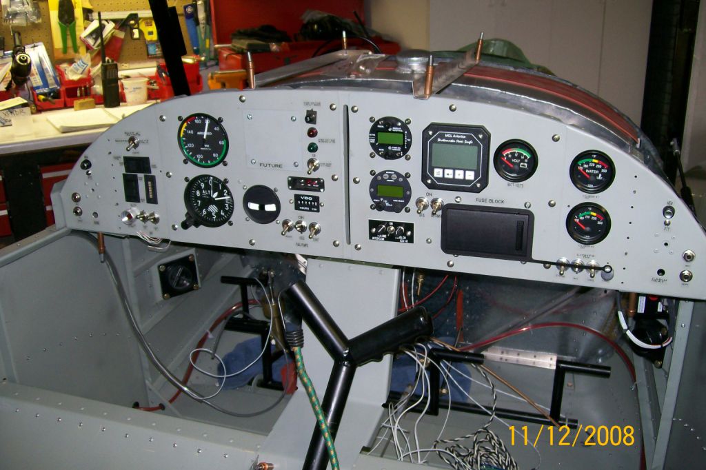

Here is what I'm doing. I have a slot in the IP in the middle for the tubing. There are 2 L's riveted to the backside of the IP. I'll use tie wraps or cotter pins to secure the tubing as in the original HDS drawings.

Thanks much for your input. Unfortunately, I don't have room left in my panel to accommodate a sight gage. I can barely start nuts using 14" pliers considering everything I have to work around.
So, here's my plan B question. What sender would you put in? I'm not worried about the wing tanks, just being able to monitor the header during wing tank fuel transfers. A sender with a "Full tank" alarm would be the most useful.
