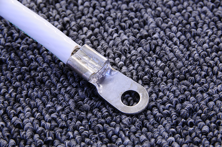

I was out soldering fat wire terminals in the hangar yesterday. There I was with Bob’s directions performing the duty as described. I poked the little 14 ga points in to fill the gaps and started adding in the solder – beautiful job, it oozed out the other end with a completely uniform ring of solder around the back edge of the terminal. Ok, nothing to do but add the shrink wrap – oops, here comes another pilot – certain trouble. Hey buddy, you know that solder is really good stuff, but you should crimp the terminal “after” you solder it.
What do you guys think? To me that would simply damage the solder job and add little value to the actual security of the wire.

At 10:34 AM 1/26/2009 Monday, you wrote:
At 10:38 AM 1/26/2009, you wrote:
>I was out soldering fat wire terminals in the hangar yesterday. There I was with Bob’s directions performing the duty as described. I poked the little 14 ga points in to fill the gaps and started adding in the solder ­ beautiful job, it oozed out the other end with a completely uniform ring of solder around the back edge of the terminal. Ok, nothing to do but add the shrink wrap ­ oops, here comes another pilot ­ certain trouble. Hey buddy, you know that solder is really good stuff, but you should crimp the terminal “after” you solder it.
Skilled soldering or well designed crimps are
interchangeable in terms of reliability. They
differ only in skill sets, tools and materials
to do the job. Doing both only goes against the
design goals both and runs a risk of degrading
what WAS a perfectly good joint.
It would seem that crimping *after* soldering is a sure way to ruin a good termination. However, adding a small dab of well wetted solder to the *lug* end of the terminal after crimping seems like a good belt-n-suspenders approach to me. What do you think of this technique, Bob?

PostPosted: Mon Jan 26, 2009 12:06 pm    Post subject: Fat Wire Terminals Reply with quote
<nuckolls.bob(at)aeroelectric.com>
<snip>
technique, Bob?
What you've shown us certainly doesn't hurt
as long as you don't get solder on the washer-
surface of the terminal and make it "un-flat".
But I cannot offer that it adds anything
useful.
