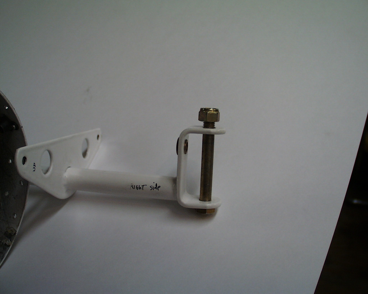

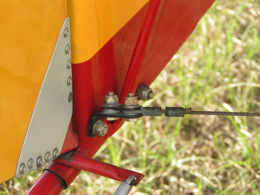

icrashrc
Joined: 16 Mar 2006
Posts: 247
Location: Mishawaka, In
PostPosted: Wed Jan 28, 2009 4:01 am    Post subject: Re: Check your Horiz. Stblzr bolts Reply with quote
John,
Saved ya the trouble of taking pics.
Smile
 Filesize:  58.6 KB
 Viewed:  885 Time(s)
 Filesize:  44 KB
 Viewed:  828 Time(s)
Scott

PostPosted: Wed Jan 28, 2009 5:11 am    Post subject: Check your Horiz. Stblzr bolts Reply with quote
Smile
Scott
www.ill-EagleAviation.com
http://forums.matronics.com//files/pict1973_218.jpg
http://forums.matronics.com//files/pict1965_113.jpg
Morning Scott:
Great!!! Thanks, buddy.

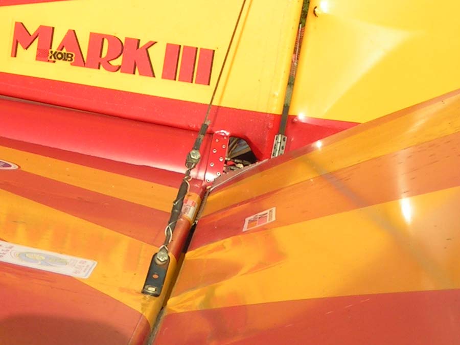

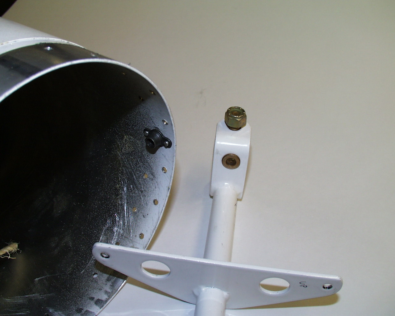

Rick Lewis
Joined: 03 Jul 2007
Posts: 122
Location: Kingston, Tn.
PostPosted: Wed Jan 28, 2009 6:30 pm    Post subject: Re: Check your Horiz. Stblzr bolts Reply with quote
Jimmy
I think I know the area your talking about. I saw this could be a problem down the road with wear on the two attach bolts at the boom tube. I have attached pictures showing how I'm avoiding this problem. Your really lucky you caught this before things turned loose in flight. The bushings you see in the pictures came from Wicks, part# SF812-4 and cost less than a dollar each. Two nut plates, four rivets, two bushing and a little work is all it takes to fix it right.
Rick Lewis
 Filesize:  148.95 KB
 Viewed:  755 Time(s)
 Filesize:  168.79 KB
 Viewed:  784 Time(s)
PostPosted: Wed Jan 28, 2009 7:14 pm    Post subject: Check your Horiz. Stblzr bolts Reply with quote
Rick Lewis
Rick L:
I haven't experienced a problem with the elevator control mechanism.
I think the problem was up at the forward attach points.
I fixed mine with a 4130 bushing I made from a piece of 1/4" tubing with a
3/16" ID. Works good.
Again, I don't think I have photos of the installation.
Let us know how your modification works out after you get some time on them.
lucien

Jimmy Young
Joined: 24 Nov 2007
Posts: 182
Location: Missouri City, TX
PostPosted: Thu Jan 29, 2009 2:54 am    Post subject: Re:Re: Check your Horiz. Stblzr bolts Reply with quote
Rick Lewis said:
>>I think I know the area your talking about.<<
Rick,
My problem was at the forward attachment point where 3/16 bolts connect the hrzntl stabilizers to the tube. I should have taken a photo.
I checked the 5/16 bolts you mentioned, along with every other bolt back there on the flying wires and control assemblies. They were all fine, but for less than $30 I ordered all new ones and am replacing them anyway.
Jimmy Y

PostPosted: Thu Jan 29, 2009 6:37 am    Post subject: Check your Horiz. Stblzr bolts Reply with quote
Rick
You have been adding a lot of bushings and stuff. My concern is that all
control surface bolts that aren't tight should have castle nuts or some
other positive safety. In your photo of your tail boom you show a nut plate.
Are you planning to safety that bolt in some way? Just be very careful when
you fix things you don't make it dangerous.
Another concern is, when people get all caught up fixing everything they
work on that they never finish their planes.
Rick Neilsen
Redrive VW powered MKIIC

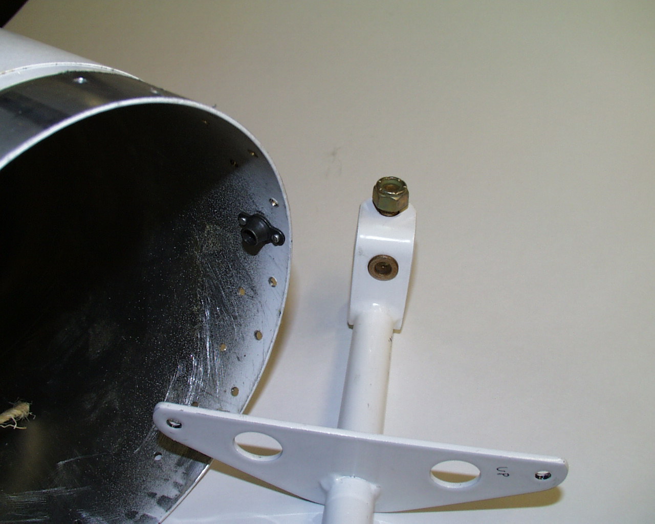

NeilsenRM(at)comcast.net wrote:
Rick
Rick Neilsen
Don't worry Rick, this bolt will be safety wired in place. The nut plate itself should lock the bolt in place but won't be relied on to do so. Thank for the concern and I appreciate the comment.
I feel the time to make these modest changes, fixes, are now while I'm building the plane since it's much easier to get to.
