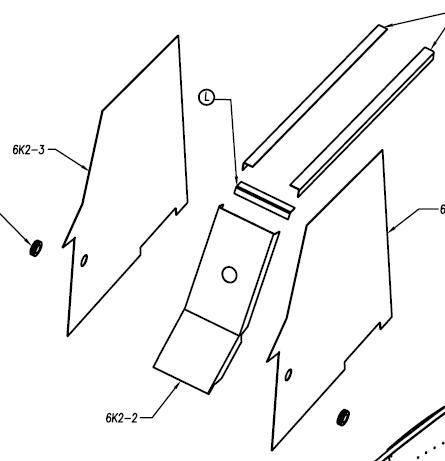

Hello, can some one help me with 6K2-3 drawing as my czaw build xl does not have this panel and also in the drawing set i have this is not included

Those are just 2 square pieces of .020 sheet. They were about 1.5 or 2 ft square in my kit. I used them for something else, but some people use them as pictured in the center console area.

i am looking for some dim. so i can make them. (i will waterjet them as i have such a tool at my work)

These should probably be field-fitted to ensure they are correct for your installation. I used cardboard and drew the rough outline needed and transferred it to the aluminum sheet.
