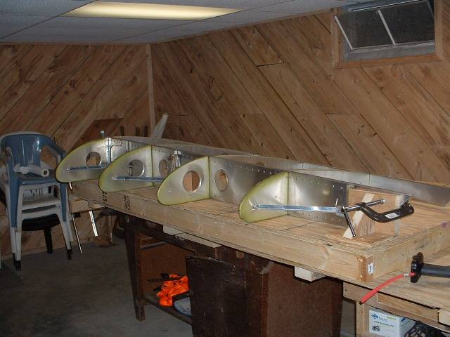

Two possibilities.
1. Your vertical shims moved while riveting the top skin, inducing an
axial twist in the wing. Duplicate the plans set-up and see if there are any
gaps in the shim contact points. If you have gaps the easiest thing to do is
to make new skins from sheet stock. Not the cheapest or least time
consuming, but easiest in the long run.
2. Measure the pre-drilled holes for the ribs along the spar and make
sure they're plus/minus 2mm.
I've experienced both, some my fault, some Zenith's. My best advice is
to nail the skeleton down while attatching the skins. Picture attached.
Bill
